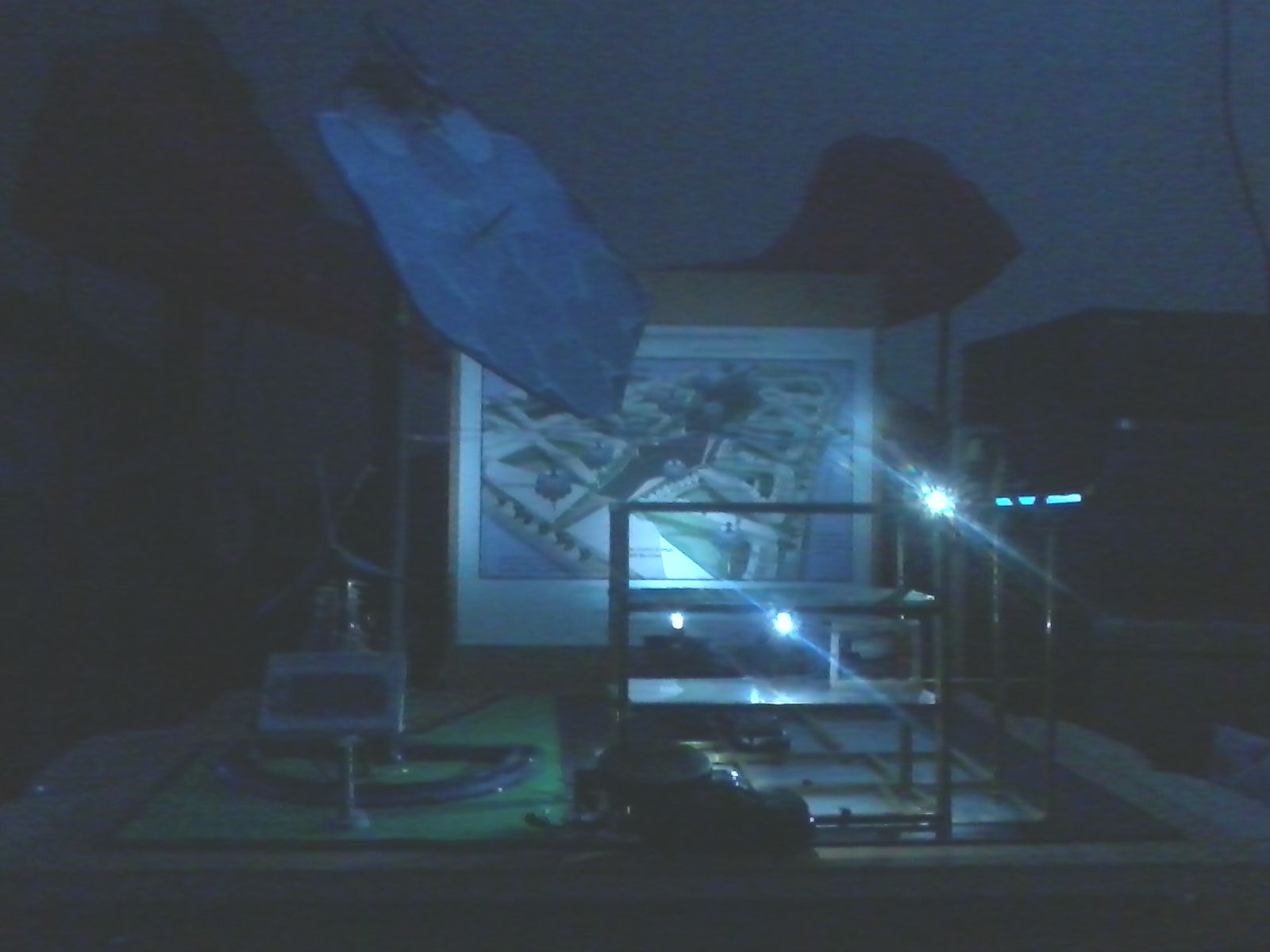

At first this was to be the final part of a 3 part series on 'Electric Bonsai' or some call it 'Steampunk Bonsai'. Then as I continued to build my device strange things began to take shape and it took on a life of its own. Within 24 hours of activation intersecting vortexes converged and some witnesses at TechShop here in San Jose brought to my attention that my device was responsible for bringing the giant atomic meteor down on Russia. http://www.huffingtonpost.com/2013/02/15/meteorite-streaks-across-russian-urals_n_2691904.htmlutm_source=DailyBrief&utm_campaign=021513&utm_medium=email&utm_content=FeaturePhoto&utm_term=Daily+Brief&utm_hp_ref=fb&src=sp&comm_ref=false#sb=860411,b=facebook
For safety reasons I shut down the device, now it sits in a dark storage closet. Yet, the solar powered robotic LED eyes continue to glow. As far as making an 'Interocitor' is concerned I will say this: when I was building the device strange objects would show up on my workbench from questionable sources. Without knowing their true function I did build these objects into the art and mysterious things began to happen.
http://www.explore-science-fiction-movies.com/alien-computers.html?fb_action_ids=601784939838361&fb_action_types=og.likes&fb_source=aggregation&fb_aggregation_id=288381481237582#axzz2LlrM7Hsq
I think powerful vortexes were generated when all of the low level force fields combined at once. The solar panels turned the wind generator, that intersected with a second solar field feeding a Lithium storage unit powering LED lights. When the two cross magnetic fields were introduced into the mix is when the compass started going crazy while in the solar field effect.
