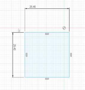

Step 1: Making the Blocks
To start, we need to 3D model the blocks. I have already made the entire braille alphabet, letters, A-Z. While this covers the basic alphabet, braille has plenty more characters. There are numbers, contractions for show words, capitals, and more. So, if you want to have a more complex set of braille blocks, follow these steps using Fusion 360: To start, you want to create a sketch and make a square that is 25.4 mm on each side. Then, extrude the square to be 27 mm tall. Next, go to the bottom of the square use the text tool, and make it go across the entire square. For this example, we'll make a B block. Follow the same settings for your text in the sketch that is in the image above so that the stamp will create the proper image, and extrude it 2 mm. Then, create the same sketch you see in the image on the top of your block. To make it, create a line down the middle of the block in a sketch, and place a circle 2.5 mm from the line (center of the circle from the middle of the line). Then, create another circle 2.5 mm away below the first one(edge to edge) and mirror it above the original circle. Then, mirror all 3 across the middle to finish the template for the braille. Finally, use the circle tool to make the corresponding braille cells. Another step is creating the .5 mm tall line on the bottom so you can tell if the braille is properly oriented.
