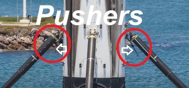

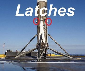

The latches on the top of the legs that hold the legs in place during the flight and the pushers at the base of the latches, that hit the leg before landing, letting gravity pull it right down.

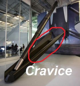

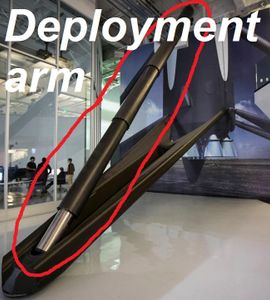

The landing legs of Falcon 9 operate mostly using gravity, once they are unlocked the pushers push the legs down. Inside the leg there is a cravice that fits a telescopic deployment arm, that locks the leg in place.
