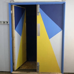

Step 4: Step 4- the Doors
So the frame for the door was already in place (see step 2) but we needed to build some doors. The doors were framed up, then we added ply to one side of them, filled all gaps with insulation (we used the polystyrene sheets) and then added ply to the other side before fitting them and adding the feather board.
