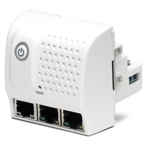

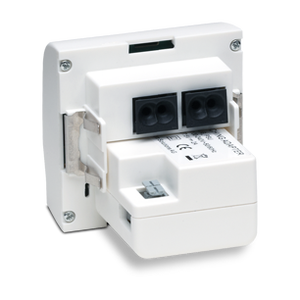

POF is an excellent solution for multimedia and intelligent home networks. In particular, POF is suitable as network backbones to mutually interconnect TV, set top boxes, NetTV, gaming, PCs, network attached servers (NAS), internet and VoIP. Carrier Networks POF is an attractive solution for telecommunication companies, cable networks and infrastructure providers to offer a completely optical solution (Vertical installations GOF (glass optical fiber), Horizontal (floor level) POF).
When the POF cables are inserted in the walls, another elegant solution proposed by the company Casacom ( http://www.casacom.ch ) can be used – All internal links embedded inside the walls are performed by POF. The optical cables connect to a small router sized as standard wall socket, having external Ethernet connectors, which can connect directly with the PC.

Dongles, switches for home and office use and wall mount modules can be ordered also at the internet site of casacom : http://www.casacom.ch or e-mail address : info@casacom.ch .
