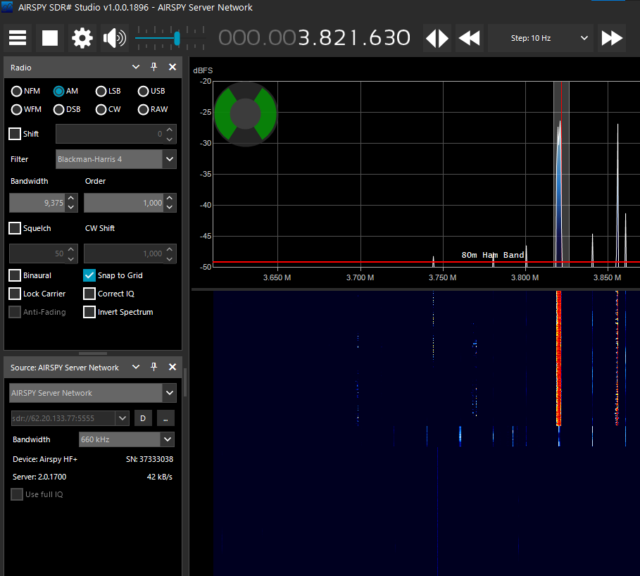

I wanted to use SDR++, The bloat-free SDR software on my Raspberry Pi 4 4GB and found an article to do so.

Having found how good SDR++ is on Windows 11, I wanted it on my Raspberry PI 4 too. I did find a YouTube article from 2021 by Kevin Loughin https://www.youtube.com/watch?v=rNhh9eueYZg&t=2s who used Alexandre Rouma's install script and source code https://github.com/AlexandreRouma/SDRPlusPlus/
Kevin was using an older version of Raspberry Pi OS and also discovered that the installation script had been written blind (untested) and had a couple of issues, he referred to cloning direct from GitHub which is common practice, but that command was simply missing. No matter, I managed to change the commands script as below and started to compile it myself discovering that the Volk software v1.0 was no longer available. A helpful bash message informed me that v2 was available and I changed the script for that. I also had to include sudo and a mkdir for the CMake folder and set those permissions for it to work. After a very long wait and a few edits as I am running the current version of Raspberry PI OS 32 bit Buster. I compiled it for an RTL-SDR, but you can change one command and compiling for other versions should be really straightforward.
