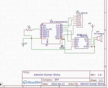

Step 1: FM Audio Bug Circuit Diagram

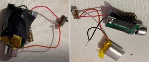

The audio transmitter used here has a mic and 3 pins as seen in the above circuit. The Vcc and GND pins are connected to a 3.3V rechargeable battery that powers the transmitter module. The third pin is to connect the antenna for the transmitting range to be extended.
The case that is being used to place the transmitter in, needs to have tiny holes, such that the mic can capture the sound. In this project, we have used a 3D-printed case by designing it accordingly.
