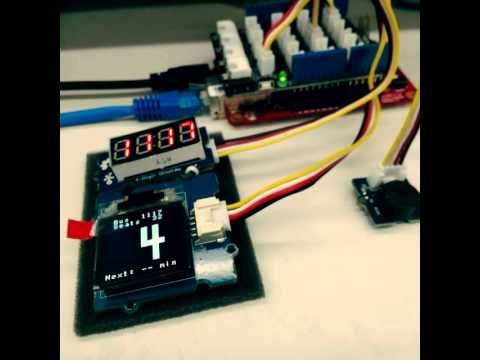

- Example Apps for testing REST APIs for WIZwiki-W7500ECO platform
- Can be monitored 4-configurable I/Os on board (ain / din / dout)
- Each Pins assumed to be connected as follows
- User IO A (P30): This pin is connected to the temperature sensor (analog input, Grove temp. sensor v1.1)
- User IO B (P29): This pin is connected to the temperature potentiometer (analog input)
- User IO C (P28): This pin is connected to the Push button1 (digital input)
- User IO D (P27): This pin is connected to the Push button2 (digital input)
- Can be monitored network settings and uptime of board

Step 3: Hardware Circuits
WIZwiki-W7500ECO - Grove Shield - Grove Peripheral
3.3V - 3.3V - None
GND - GND - None
P30 - Analog0 (A0) - Temperature Sensor
P29 - Analog1 (A1) - Potentiometer
P28 - Digital2 (D2) - Button1
P27 - Digital3 (D3) - Button2
- [WIZwiki-W7500ECO] and [Grove Shield] is connected via jumper wires.
- [Grove Shield] and [Grove Peripheral] is connected via grove universal 4 pin cables
