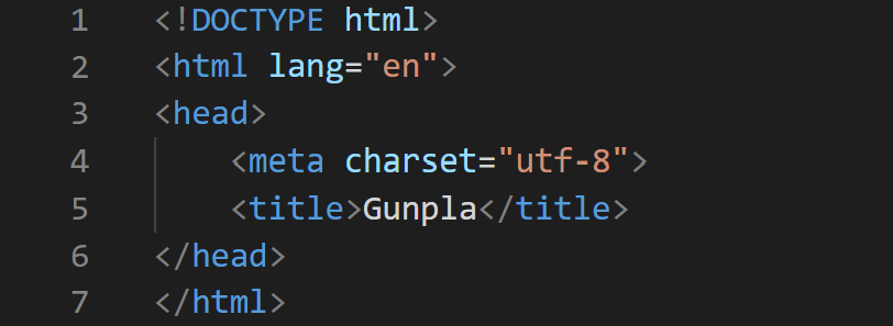

Step 2: Step 2: Head Element
Now we will add the element to our webpage, this element generates a section where we may insert machine-readable information about our website. Browsers and search engines largely utilize this information to comprehend the page's material. The contents of the element are not accessible on the web page.
The HTML element is a semantic element in the sense that it informs the browser and the creator about the webpage content's purpose. Semantic elements have been used to enhance an HTML document's human interpretation, offer more data to the browser for comprehending the text, and improve site accessibility and placement.
It's worth noting that you'll now be nesting a number of HTML elements within each other.
Adding a <head> element to your site generates a section where we may insert machine-readable data about our web content. Browsers and search engines largely utilize this data to comprehend the page's content. The contents of the <head> element are not displayed on the web page.
The <title> and <meta> elements should be nested in the <head> element, while the <head> is nested in the <html> element.
Now, let's have a look at the significance of the code we just introduced. The line of code following the opening tag sets the document's character set to UTF-8, a unicode standard that accommodates the bulk of characters from a broad range of grammatical constructions.
The element is used to set the title of the HTML page in the line of code. The information you enter in this section will appear on the browser tab and in the search engine results as the webpage title, and it will not appear on the page itself. Change "Gunpla" with your own name or the title of the webpage you're creating.
element is used to set the title of the HTML page in the following line of code. The information you enter in this section will appear on the browser tab and the search engine results as the webpage title, and it will not appear on the page itself. Change "Gunpla" with your own name or the title of the webpage you're creating. </p><p>At this point you would close off the html tag with (note every tag ending contains a forward slash before the tag itself) and have a starting webpage by saving the file as my first webpage then clicking the file to open with your preferred web browser. However, let's take it a step further and flesh out a fully formed webpage.</p></p>

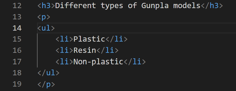

Step 4: Step 4: Lists
Aside from the usual text that we can put in our <p> tags we can also nest lists in them as they are also blocks of text. There are distinctly two types of lists an unordered list and ordered list.
An unordered list is a grouping of objects with no particular order or succession, whereas an ordered list has a particular order and succession and is indicated numerically. In this example we will be using unordered list to list different types of item materials.
The <ul> element is used to create an unordered list. The <li> tag is used to begin each list item. The standard default, the list elements will be marked with bullet points and this list will be nested in the <p> tags under a header for context.
