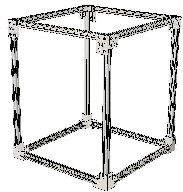

Step 1: The Frame
The main structural feature of Atomic U300 is an open frame with aluminum extrusion profiles, whereas the original Ultimaker 2 has a closed case made of aluminum composition panel.
The aluminum extrusion profile is not only less expensive but also easy to expand and modify.
- Left: The Original Ultimaker 2+
- Right: Atomic U300
The Size of the frame is 420 * 420 * 500mm. I think this is nearly a minimum size to print a 300 * 300 * 300mm object.
The table below shows the higher build volume ratio of Atomic U300 design.

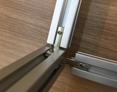

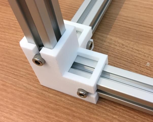

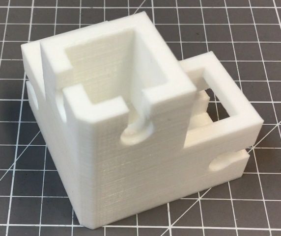

For more efficient assembly, I designed a 3way corner bracket for the bottom of the frame. This 3way corner bracket makes it easier to assemble three aluminum profiles in a perpendicular position to each other.
The assembly of the frame starts with bottom corner brackets. Next, fastening inner brackets and corner brackets of the topside.
You can see all the details of the frame assembly process in the following video tutorial.

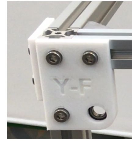

XY Axis Brackets

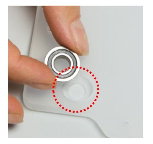

In the original Ultimaker 2 design, the case panel has holes for ball bearings. Each hole holds a ball bearing for a linear shaft inside.
The jasonatepaint’s ‘Ultimaker 2 Aluminum Extrusion Clone’ introduced a separate XY-Axis bracket. This bracket holds a ball bearing inside. Because attached under the 90- degree angle corner, it consumes some space of X-Y axis motion length.
- Left: Original Ultimaker 2 - Ball bearing and a bearing hole in the panel
- Right: ‘jasonatepaint’s ‘Ultimaker 2 Aluminum Extrusion Clone’ - Bracket for the ball bearing
I designed a new bracket for the XY-Axis ball bearing in a space-efficient way. By the side attaching design, these new brackets can be much smaller and also work as corner joint brackets.
And by this design, I could shorten the distance between the frame and the linear shaft.

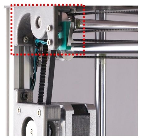

I spent a lot of time and effort in designing and improving the new Printhead because most of the 3d printing quality depends on the Printhead. And also, the design of the Printhead affects the moving distance of the X-axis and Y-axis. And it restricts the X and Y printing size in the same frame length. I had redesigned and fine-tuned the Printhead design more than ten times.
At the beginning of the design, the ‘HyperCube Evolution’ by ‘SCOTT_3D’ gave me an inspiration for a hot-end attaching structure. On that base, I added design elements one by one: linear bearing carriages, cooling fan holder, Z-Probe holder, and wire-organizer on the top.
I deliberately separated the X-Axis and Y-Axis bearing carriage to minimize the support structure when 3D printed. And as you can see in the picture below, I positioned the hot-end cooling fan inside the Printhead to minimize the width of the Printhead.
- Left: CORE-XY Style Printhead of HyperCube Evolution by SCOTT_3D
- Right: Ultimaker Style Printhead of Atomic U300 by MakeTogether
I believe that this is one of the most compact Printhead design for the Ultimaker style mechanism.

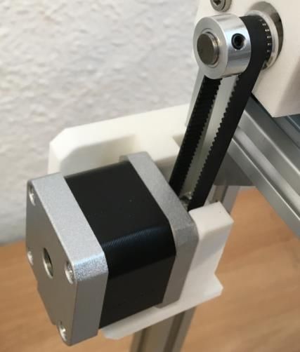

Step 4: XY Motor Bracket

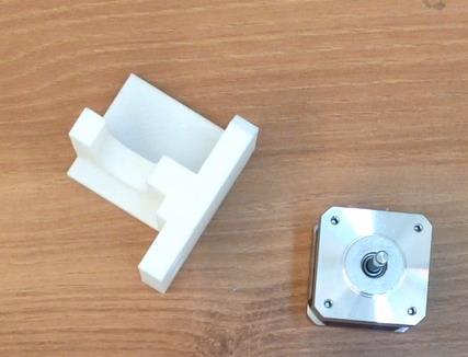

For the Ultimaker style XY mechanism, you should connect the X and Y motor to the linear motion shaft with a closed-loop timing belt. So we need brackets to attach the XY motor onto the 2020 profile frame.
I designed a bracket for XY Axis motor. X and Y motors use the same bracket. You can apply this bracket design in other projects when you connect NEMA 17 stepper motors to 2020 profile frames.
- Left: Stepper motor and the motor bracket
- Right: Motor and timing pulley connected with 200mm closed-loop GT2 timing belt
By locating the XY motors outside the frame, I could minimize the X and Y frame size.
Because the timing pulley is linked to the motor outside of the frame, a longer linear shaft, 450mm, is needed. And also, the backside X-Axis and Y-Axis bearing brackets are modified to give a little space for the timing pulley outside.
The following video will show you how to assemble and attach the XY motor brackets.
