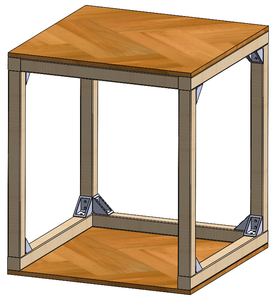

Step 3: Assemble the Side Frames
I designed this to be assembled into the side frames, then the side frames are joined together. and then the top, bottom, and sides are installed.
To assemble a side frame, connect 2 of the 21” and 21 5/8” pieces as show. Be sure to place the 21” piece inside the other. This will make a stronger joint as the force can move down the vertical piece in the final assembly. The other way will have all the force being supported by the printed bracket.
Use a corner bracket in each corner with 2 screws in each side.
Do this for the other side frame too.
Note, I did use a pilot hole for the first few but found it was not needed so stopped doing it.
Step 4: Connect the Side Frames
To join the side frames together. I use the remaining furring strip pieces and the remaining corner brackets to join them at the corners. Again see the image.
For the front I placed the corner brackets on the back side of the strip to give more clearance.
Also, I only use 3 here not four to keep the bottom front clear, this wont cause any issues once the bottom is attached.
