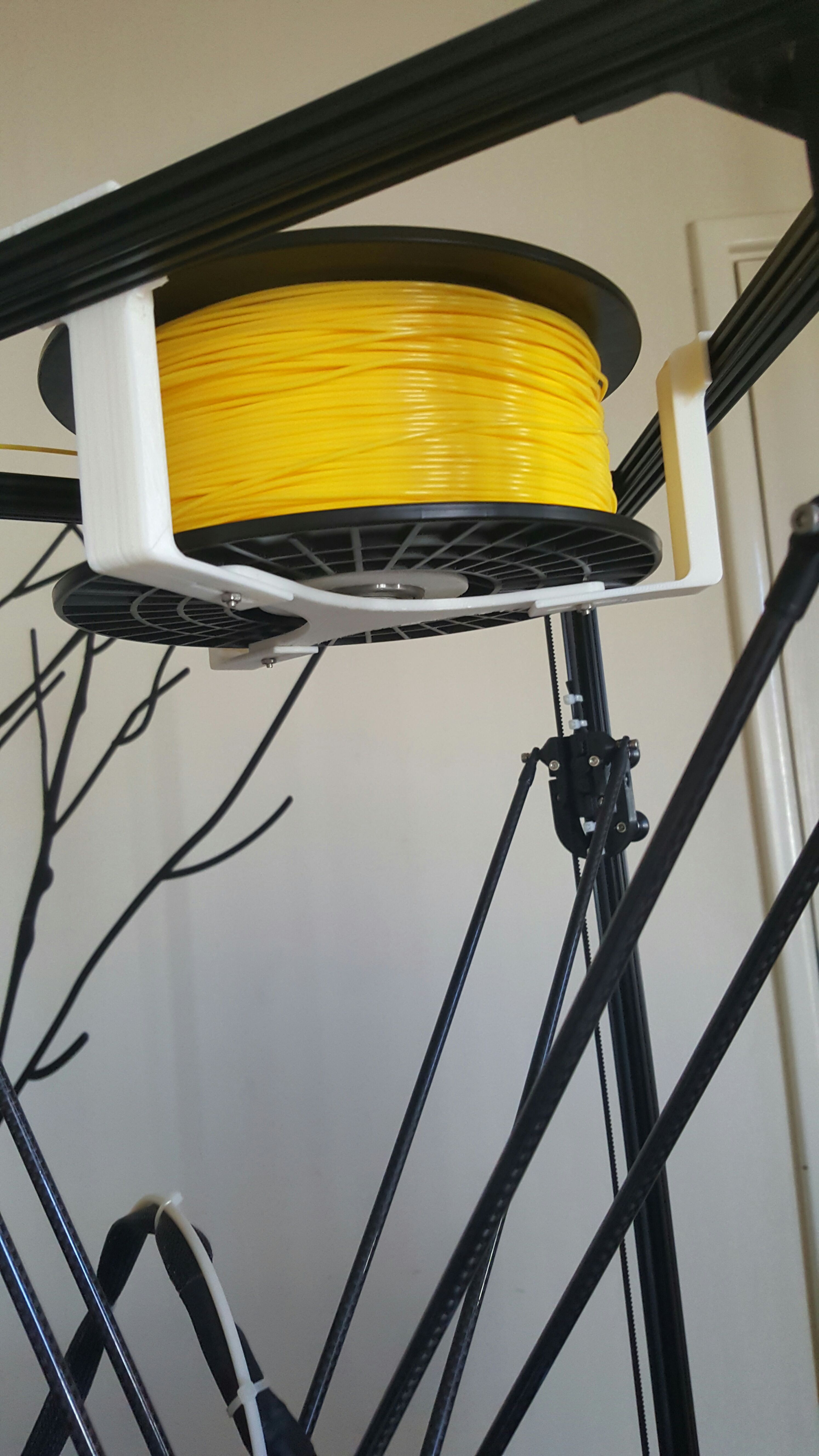

Introduction: Building a Cheap Delta Printer
About: I've always loved tinkering and disassembling thinks to get a better understanding of how they work but there are only so many things you can take apart. Thats when i started to improve on them and sometimes m…
The Kossel XL Delta printer is a great piece of hardware to have you can either buy it in a kit I recommend builda3dprinter.eu it takes about a month for a full kit to arrive and they are roughly £560 ($650 US) ($860AUD) or the individual parts can be bought for significantly less (About $550AU or $420USD) but you run the risk of buying fakes or DOA electronics because most parts are sourced from china.
For the price this printer has a Very big Build Volume 25cm in Diameter and 27cm in height or 20cm x 20cm x 27cm for square objects.
