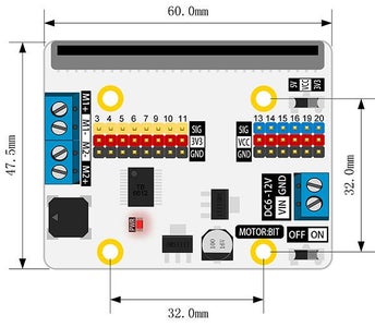

The ELECFREAKS micro:bit Motor:bit is a motor driving board designed for the micro:bit. It integrates a TB6612 motor driving chip, which can drive two DC motors with a maximum 1.2A DC single-channel current.
The Motor:bit also includes ports for connecting the ELECFREAKS OCTOPUS series of sensors and 1 I2C communication port, allowing you to extend with various sensors and electric modules.
Additionally, the Motor:bit includes a passive buzzer for playing sounds. It is designed for students and can be used to create a smart car or other interesting projects. The Motor:bit supports a power supply of 6-12V DC.

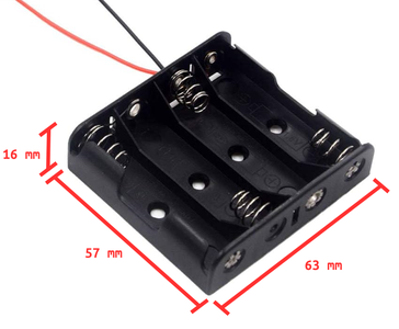

FDM 3D printer (Ideally a newer generation high-speed printer)
1x 1kg spool of inexpensive FDM filament for prototyping
4x AA batteries
Digital caliper

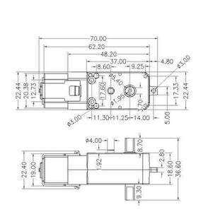

- Instruct the students to measure the motor and draw a motor diagram in their engineering design notebooks.
- Have the students write a brief reflection about what they have learned about measuring the motor below their diagram.
Measurements will vary. This is an excellent opportunity for students to discuss their measurements and diagrams with other students. They often learn from one another in this process. Here is an example diagram from a student diagram of a motor:
Here is an example from a student diagram of a motor in their engineering design notebook:

- Distribute a motor and the datasheet with the motor diagram and all the measurements to the students.
- Have the students observe the motor and the given measurements on the diagram.

- 1x ELECFREAKS micro:bit Motor:bit

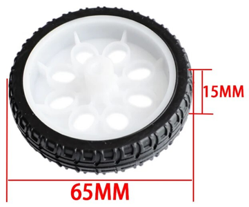

- 2x Wheels for DC motor

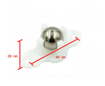

- 1x Caster wheel
- 1x 4 x AA battery holder

- ELECFREAKS Motor:bit
- Caster wheel
