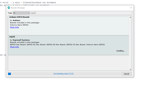

Step 3: Coding PreSetup
ESP32 board URL:
https://dl.espressif.com/dl/package_esp32_index.json
  1. Open Arduino IDE
  2. Click on files then Preferences Or Ctrl + Comma
  3. In Additional Board Manager URLs: Paste the above link ↑
Esp32 library:
  1. Go to Tool
  2. Then Board
  3. Then Board Manager
  4. Search for 'esp32'
  5. Then install it.

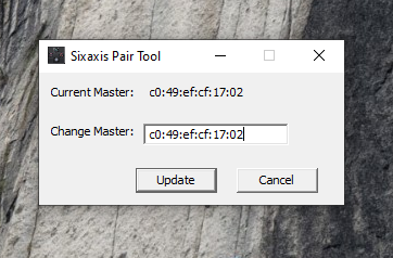

Step 6: Set PS3 Controller Master Address
  1. Download and Install SixaxisPairTool Link
  2. Open the application
  3. Paste Mac Address of Eps32
  4. Connect your PS3 Conroller to PC
  5. Click Update
