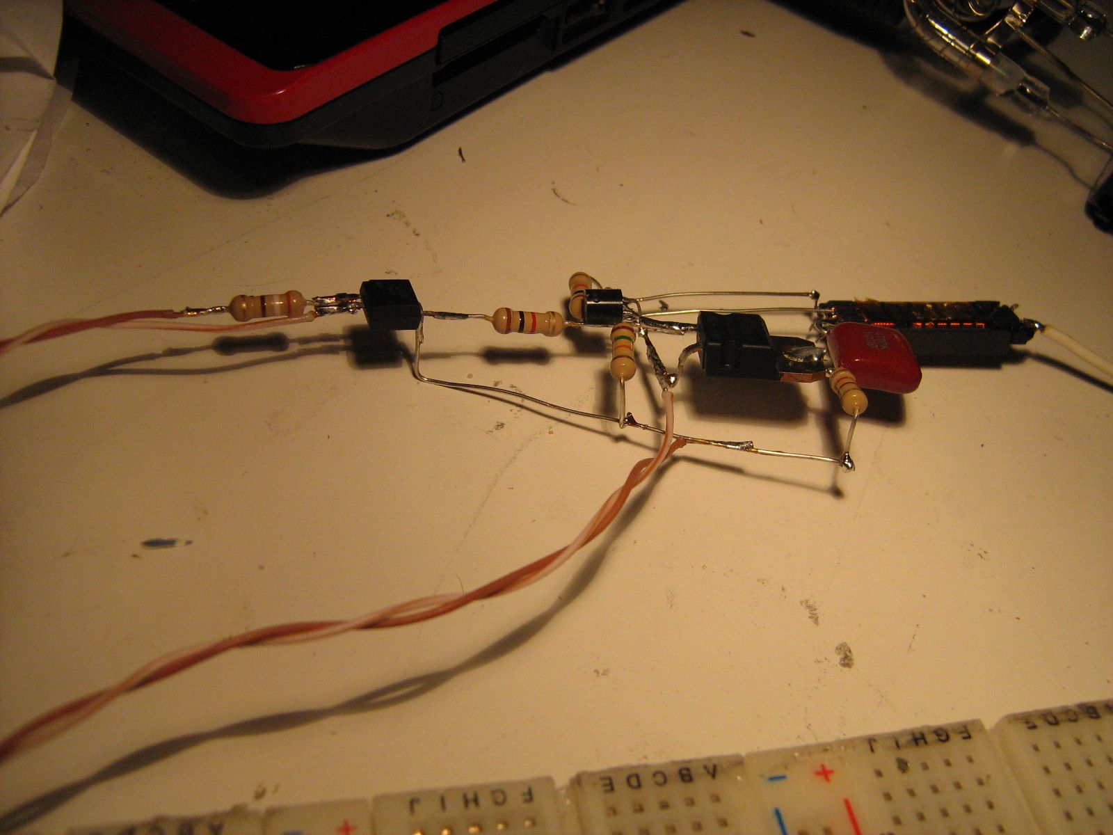

Introduction: Building a Capacitive Liquid Sensor
A capacitive liquid sponsor relies on the fact the the capacitance or charge between 2 metal plates will change (in this case increase) depending on what material is between them.
This allows us to create a level sensor that is safe for use with any liquid, this one will be used in a buggy with gasoline (petrol).
One plate is hooked to ground. The other connects to pin 23. There is a 820K ohm resistor from pin 22 to 23. The sensor works by charging the capacitor (the water bottle) and measuring how long it takes to drain through the resistor.

Step 6: Make Capacitive Sensor
For testing i used aluminum foil and a plastic water bottle, It will work with any container so long as it isn't metal.
You can use any type of wire but any non shielded lines will provide poor performance.
You can use any 2 pins, I chose 22 and 23.
Connect one side to ground and the other to a resister and 2 I/O pins.
