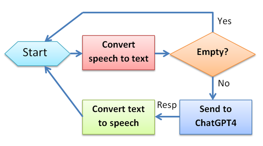

Step 1: The Idea
ChatGPT is an advanced artificial intelligence developed by OpenAI. It is designed to engage in natural language conversations. ChatGPT can assist users with tasks, answer questions, brainstorm ideas, and even generate text in different styles, making it a versatile tool for communication, learning, and problem-solving.
Text is the bridge between ChatGPT and human. If we use speech recognition to convert what we say to text, we can talk to ChatGPT. If we use Text-to-Speech technique to read the text generated by ChatGPT, we can hear ChatGPT too.
The idea is straightforward and is really nothing unique, but I really like it and I do it out of fun. I will use free API/service only, so the investment is just time, and I learned a lot from it and enjoyed the process.

Step 3: A Very Simple Prototype

The speak() function accepts text parameter and calls gTTS to generate MP3 accordingly, and it uses pygame.mixer to play the MP3 without saving it into file.
This program demostrates how to convert human's speech (from microphone) to text, and then forward that text to ChatGPT4. As a very simple example, it works and you can chat with it already. Try to ask it some simple questions like "what day is today?" or "which country has tallest people?", you will find it actually answers your question.
However, there are still some issues to address:
Lack of context
This is the biggest problem. The AI always starts a new conversation whenever you ask a new question, you will feel frustrated because the AI doesn't remember whatever you have previously said. This prevents you to chat deeply about a topic with the AI.
Long waiting time when ChatGPT output is big
This is also very obvious. ChatGPT likes to talk, a lot. It sometimes generate thousands of words to answer your short and simple question. You may have to wait for long time when those output are processed.
Lack of GUI
It will be much nicer if the voice assitant has its own GUI, instead of printing the output on the console.
In following steps I will address these issues one by one.

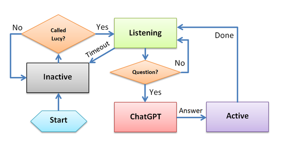

Step 6: Make the GUI
I create a fullscreen window as the GUI for this voice assistant. The conversation will be displayed on the screen when the chat goes on. I also define three states for the program: inactive, active and listening.
The three states
When the program just launched, it is in "inactive" state: the screen is black and it will not react to what you say.
If you say something that contains "Lucy", that will trigger it and its state will become "active" and immedetely go to "listening": the screen is green and it listens to your question.
After you ask the question, its state will go back to "active" while ChatGPT is outputing the answer: the screen is purple and your speech will be ignored. After all output are read out, the state will go to "listening" again.
If you haven't say anything after a while, the state will go to "inactive".
The GUI uses CSS to change the color of widgets.
