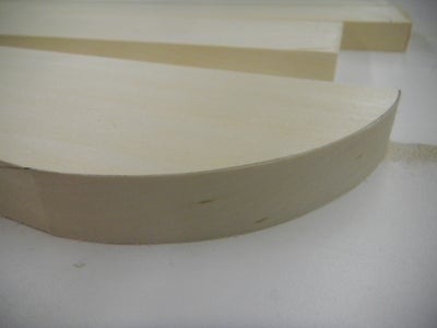

Step 3: Sanding the Curves
In order to speed up the process of cutting and sanding the curved ends, I built this quick and easy sanding jig. All you need is a flat base, with a 3/4" strip glued to the bottom to match the track on your sander. The board that you attach on the top simply needs to pivot 3-1/2" from the edge of the base.
It's important that you don't sand the ends of the arms so that the length ends up being less than 18". I find that students often get carried away when they sand because it's so much FUN!

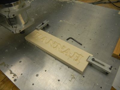

Step 6: Customization
Now if you're lucky, you have access to some sort of CNC at your school or work. The ability to customize these chairs makes them fly off the production line at Christmas time and whenever someone you know brings a little one into the world.
If you don't have a CNC, you can invest in some letter templates for your hand held router, or even wood burn some designs on the front. Heck, you don't have to put anything on there at all.
Please remember to put your design on one of the seat pieces that is 12-1/2" long. Again, pick the nicest piece, as this will be the one that everyone notices.

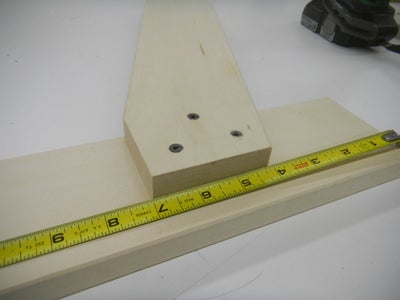

Step 10: Assembly PART 4 - Attach the Arms
When attaching the arms, it's a good idea to lightly mark out the position of the arms in pencil on the underside of each arm.
- The exact measurements are listed on the plans. Again, it's hard to design a jig for this step because you get so many slight variations at this stage.
- The positions of the screw holes should be marked on the top of each arm and countersunk.
- You can then position the arms in place by lining up the light pencil lines.
- Hold it tightly in place and install the screws.
- In the last picture of this step, you'll notice that I made the mistake of laying out the countersink holes in the wrong position. Please don't repeat my blunder. I think I got distracted by all the photos I was taking during this process.
- Problem solving time......
- This was solved before moving on to the next step.
