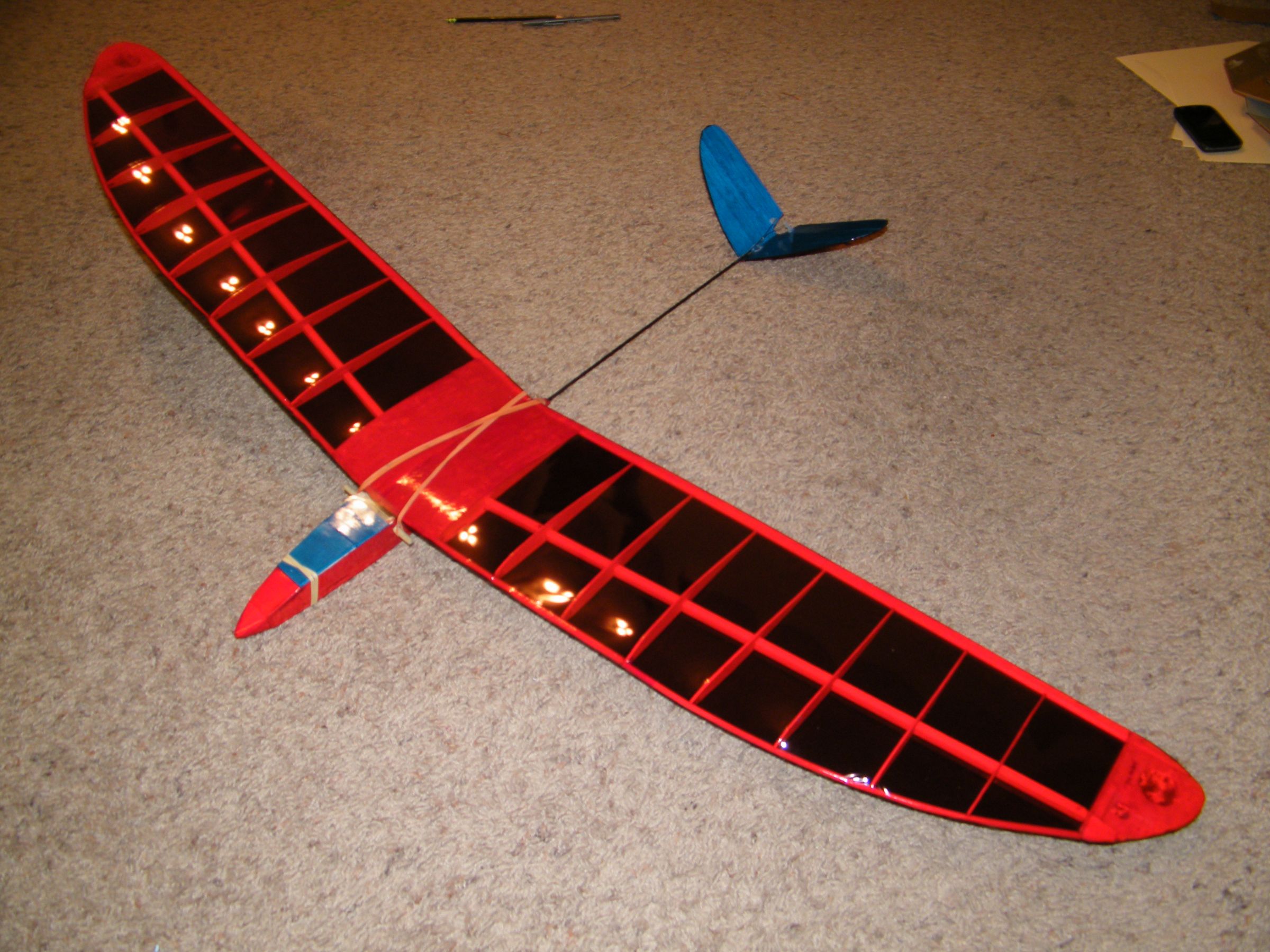

Step 9: Conclusion & Coming Soon
The finished weight on this set of wings is 129.9 grams. The Wingspan is 38.5 inches. I haven't calculated the precise wing loading but its more than low enough for this airplane. I haven't taken them for their maiden flight yet, I will have to update this later. The finished weight for the set is 150.2 grams. Im guessing the finished weight of this model will be around 375-400g depending on the battery I choose.
