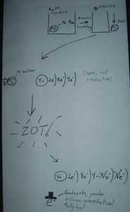

Here's a small comic which demonstrates how the detector was originally supposed to work. I have no illusions of being good, or even acceptable, at drawing.
What actually happened was not a sudden change in the conductivity of the photodiode silicon lattice, but a short-lived buildup of charge as demonstrated by the oscilloscope photographs, akin to the photoelectric effect.
Reverse-bias is *supposed* to improve event capture by expanding the depletion layer, and cause the charge buildup to be shorter lived (but still visible), improving performance... but I could not conspire to get such a thing to work.

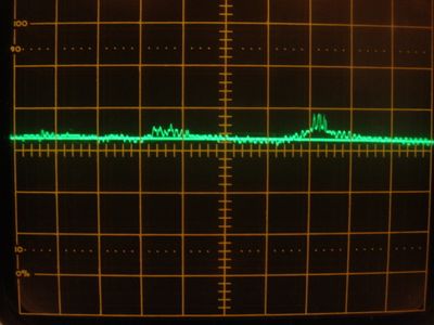

Our first image here is the entropy source the modified photodiode at a "medium" sampling rate, encased in the new EMF shielding. The extremely rapid oscillations present in two parts are artifacts of my quirky oscilloscope. The voltage spikes followed by the apparent logarithmic decays are our quantum incidents.
Our second photo is similar, but at a higher sampling rate showing the individual incidents at a better resolution. There just happen to be 4 in a row in close proximity... this was not commonly observed, but made for a cute photo.

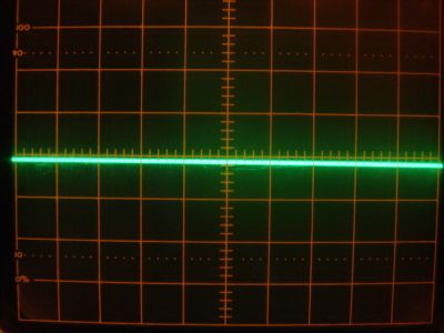

Our final photo is a pseudocontrol. It is an unmodified photodiode encased in the same shielding, with no entropy source. The scope settings were preserved as compared to the previous two photos. As you can see, there is a lot of nothing happening!
I say "pseudocontrol" since it is an unmodified photodiode. The modification consisted of removing the glass window protecting the semiconductor... and I do not immediately feel like either disassembling my working detector or getting covered in ground glass again carefully removing the window.

The results were immediate and drastic. The 60Hz interference as well as the (mysterious) ~200Khz interference I always pick up are apparently completely eliminated by this trivial modification. There are nice voltage spikes visible, and look exactly as they should.

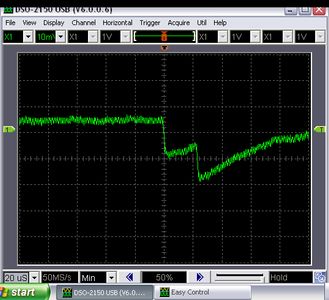

For now, I leave you with the readout from a Hantek DSO-2150 USB 150 megasamples/sec scope, that has been amplified using a differential amplifier based on the OPA 2132... It shows the impact of 1 or 2 helium nuclei at ~5MeV, overlapping. Note how they produce peaks of the same amplitude, suggesting two particles of similar energy hitting the detector. It is also (remotely) possible that one particle had an elastic collision, and then hit another silicon atom in the detector a second time within 20 microseconds, or that there was some sort of secondary emission, but in this case we would expect it to be unlikely because the two peaks have similar amplitude.
The particle detector meets all design goals. It detects the incidence of alpha radiation with excellent resolution and low noise. The next phase of the project is data acquisition, statistics, and the construction and programming of a microcontroller that interprets this data in such a way that a computer can make use of it. This will be called the "Quantum Entropy Accumulator", since... well... it accumulates entropy from a quantum source. Forgive my lack of originality, I'm tired.
