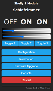

Please configure the module, as shown on the screenshot. The configuration is as shown below:
  • POWER1 will now control the relais of the actuator
  • POWER2 controls GPIO1 (for example the blue LED)
  • POWER3 controls GPIO3 (for example the red LED)
As POWER2 and POWER3 are configured as PWM (Pulse Wide Modulation), you can configure the brightness of the LEDs through the UI or MQTT.
