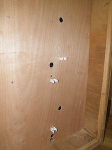

    Step 9: Cut the Pipe Holes
    At this point it's time to cut four holes in the divider between the main section and the side section of the dishwasher. Two pipes will bring water to the tubs, and two will drain water away. Measure the distance from the front of the frame to the back of the tubs. You want the water to come in right behind each tub and preferably just a bit higher than the bottom of each one (So water will tend to flow out of the machine rather than sit in the system. Not a big deal, really).
    The holes for the drain pipes need to be placed more precisely. The funnel-and-elbow system you made in the previous step to collect water from the drain will run a pipe straight to the holes we cut in this step. You want the funnel as close to the bottom of the tubs as as possible, and to fit right over the drain pipe (in a future step we'll cut a notch in the funnel so the tubs can be moved in and out freely. The center of the funnel should be a bit farther forward than the center of the drain pipe, so water won't spill out the notch. Measure the height the drain needs to be, and make the holes low enough that the drain pipe can have a tiny slope downwards.
    Measure, mark, and cut the holes (Trace around a short piece of pipe to mark the size you need to cut). I found using a large drill bit to cut several holes and then using a rasp to remove the rough parts worked quite well.
    Step 10: Add the Water Supply Pipes
    Measure the distance between the water supply holes you cut in the previous step, and cut a piece of pipe that length. It helps if you hold an pipe elbow at the top hole and a tee at the bottom hole, mark where they are, and measure between those markings.
    Melt a pipe elbow onto one end of the pipe and a tee onto the other (make sure the elbow and tee point the same direction!).
    Then cut two pieces of pipe at least 2 inches long (5cm) and fuse them to the elbow and tee. The piece should now fit through the holes in the wood. If the holes are a little off you may have to make them a bit larger.
    Then use pipe clamps and hose to connect the water supply pipe to the tubs' input pipes.
