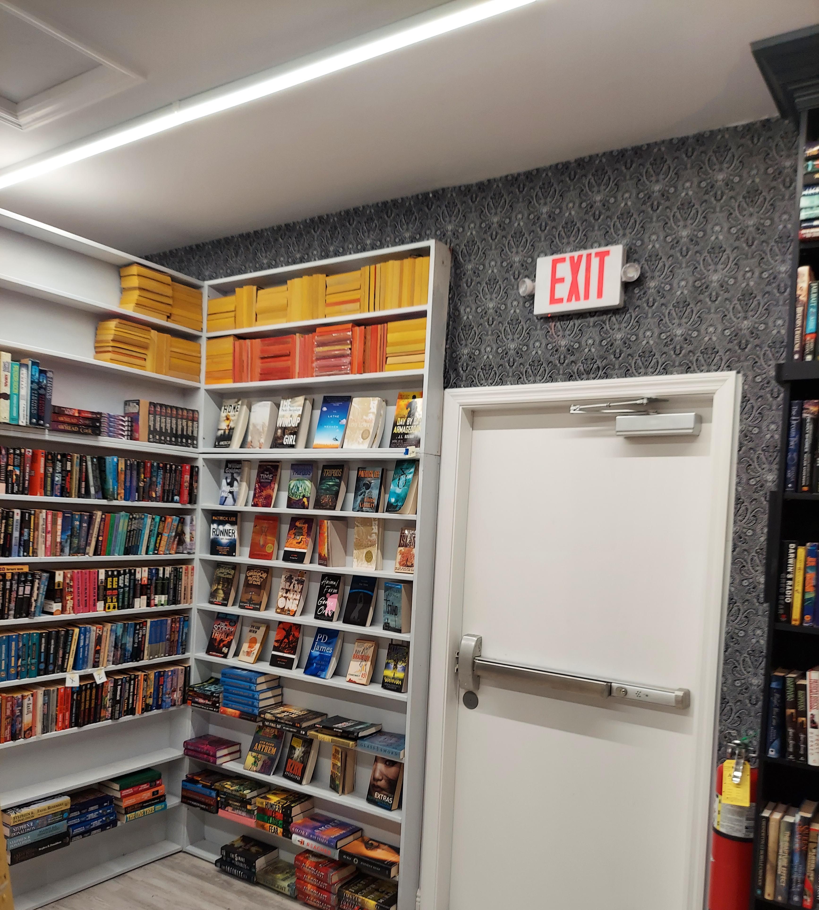

Step 1: Location, Location, Location!
The first consideration is to designate a suitable location for the Sandman Books Arch. My plans call for a 9 foot tall frame by 25 feet in length but you can make a much smaller structure. In my case, I am 6'5" tall and desired an arch I could walk under without hitting my head. The second consideration is weight, especially if you are building an arch in a residential building. A quick estimate reveals each book weights approximately 1 pound plus the weight of the 2x4s, osb and fasteners. My design called for 5,000 books, so I had to accommodate at least 5,500 pounds. Luckily, the floor was reinforced concrete and more than adequate to support the arch. A smaller arch will weigh considerable less.
