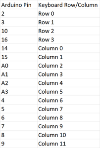

Step 6: Connecting the Microcontroller
After connecting all switches into rows and columns, we need to connect all 4 rows and 12 columns onto the micro controller. In total there should be 16 wires connecting to the controller.
You can wire the rows and columns to whatever pins starting with a "P" showed on the above Pro Micro pinout diagram. My wiring diagram is also shown table above.
Note 1:
- Top most row is row 0; Bottom most row is row 3.
- With keyboard keycaps facing up, left most column (normally where ESC key is) is column 0; Right most column (normally where BACKSPACE key is) is column 11.
Note 2: The diagram is for Arduino Pro Micro only. I would suggest look into this guide if you are using other micro controllers: How to use a Pro Micro as a cheap controller/converter.

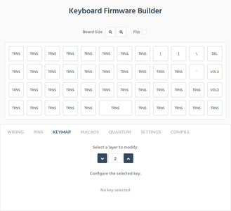

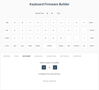

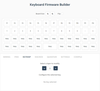

Step 7: QMK Firmware Configuration
A QMK Firmware is responsible for two major things:
- Detect which key is being pressed by the user.
- Output the corresponding keystroke to the computer.
Here are the following steps in creating the firmware:
- Navigate to https://kbfirmware.com/.
- Match the pins that are connected to each row and column. Refer to the Pro Micro diagram for the pin numbers. My pin settings are shown in the above image.
- Edit the keymaps, this is the keys that the keyboard will tell the computer whenever you pressed a key. Note you can have multiple layers using layer keys. My board has two layer keys with each next to the space key.
- Navigate to the "Compile" tab, and download the .hex file. This is the firmware that will go into our Pro Micro.
