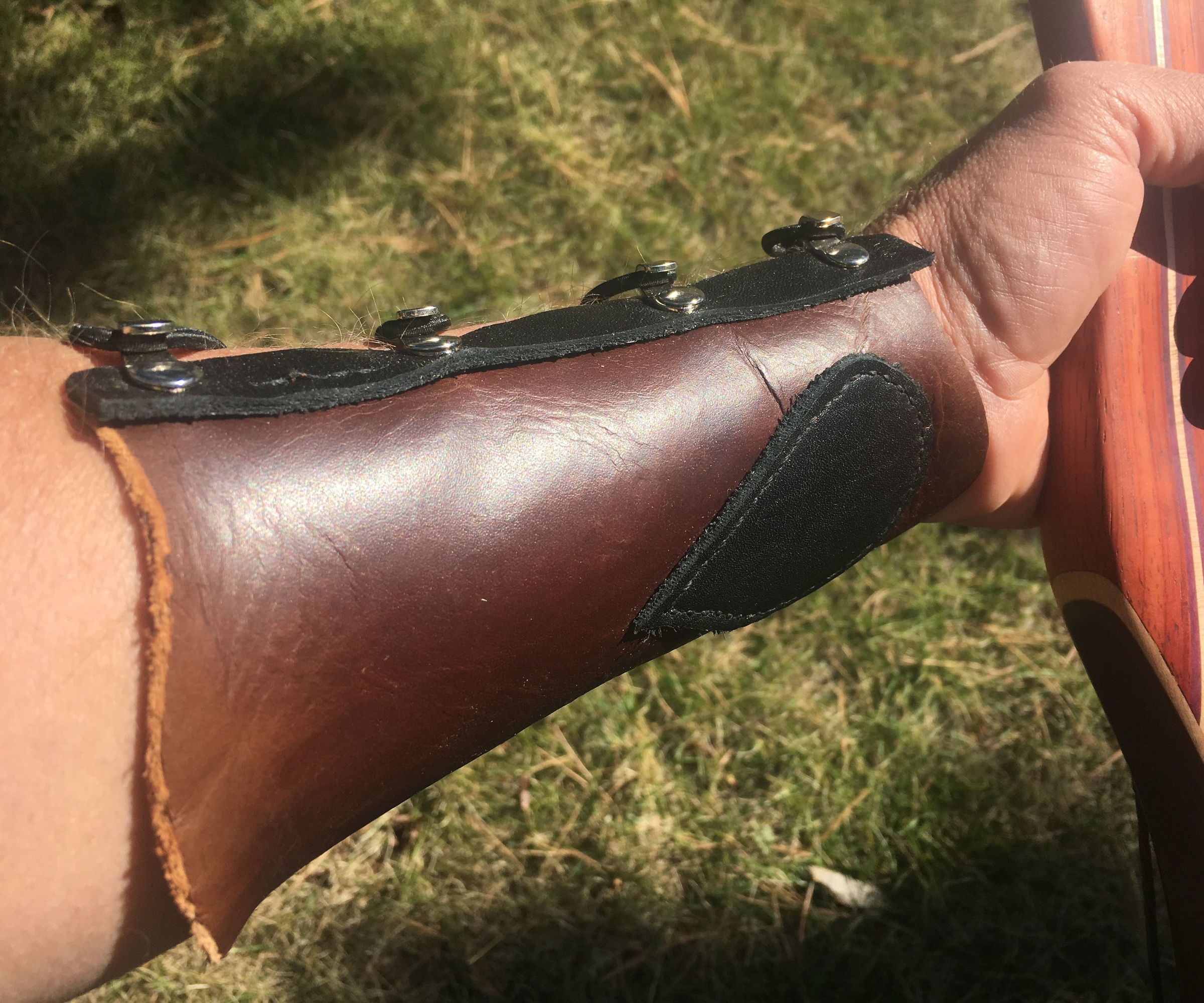

This stage is a difficult one for me. I'm excited about finishing the bow and heading outside to shoot. However, attention to detail is pretty important. I found myself going back and forth with the Surform rasp, file and sanding blocks. Changing shape and fine tuning the "feel of the grip" is time consuming. But when it is done, you will have a truly custom long bow. I did not use a thick, store bought Spar finish yet.
I oiled the riser, went out and shot a few arrows, and then headed back to the barn for a little more sanding. I get to a 600 grit and find that it feels really smooth to hold. Some may say a finer grit is necessary, but personal preference is really the key. If you are putting a leather wrap around the handle, smoothness and finger contours may not be on the top priority list. Nevertheless, take a chance and build your own personal long bow. Find a local archery shop, and take it in for a little critique from the Pro's. We received valuable feedback from a couple of different guys.
