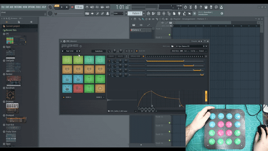

Step 7: FL Studio
I decided to use FL studio to test the MIDI controller. There are many alternatives DAW's available that you can use. To setup the MIDI controller for a drum pad is straight forward. In FL Studio click on OPTIONS go to MIDI settings. CircuitPython will be shown as an Input and Output. Make all the necessary settings as indicated in the Figure above.
To setup the MIDI as a drum pad search FPC and click on the arrow pointing downwards. You will now have the option to Map notes for entire bank, where you can go from bottom left to right move a row upwards and go from right to left and repeat until you reach the first button.
