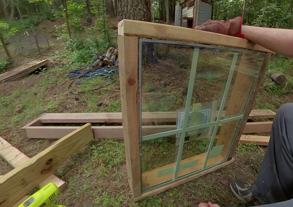

Step 7: Windows
I put this as step 7 because this is the point at which I added the actual windows to the shed, just to be safe. However, incorporating the window frames is part of the wall building process. There's a bit of jumping around in the actual building process of the shed, so needless to say that can come across in the step-by-steps as well!
To add a window to the shed, pick where you want a window and which of the windows you've found fits best. Measure the window itself, and build a frame of 2x4's that has an opening that's just slightly larger than the window's dimensions. Double check that the window does, in fact, fit the window frame before adding it to the frame of the shed itself. I tried a couple of tactics for fitting the windows, and the easiest way to fit windows in was to cut thinner pieces of wood to fit the frame and have them on the outer section of the window frame. That way, you put the window in place by just pushing it up against those outer pieces. Then you can fit the window in place by using your best insulation option and adhesive, and you can additionally add a similar inner frame on the inside to create what's effectively a window sandwich to keep it snugly in place.

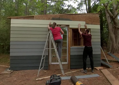

Step 8: Finishing the Walls
My assumption is that whatever dumpsters you're working with are associated with builds, and whatever builds are happening need to be safe from the elements. When you walk by a work-in-progress building, sometimes you'll see siding covered with this massive paper stuff. That's essentially a waterproofing layer, and I do wish they had thrown some of that in the dumpster for my project. Either way, there's something being used to protect your plywood from the elements, and you can look to do the same. Some wood also is treated such that it doesn't call for the same level of protection.
In my case, while I do wish I had an additional waterproof layer, I added a full set of siding all around the shed to create a protective barrier. Plus, it looks really nice! In my opinion, anyway.
