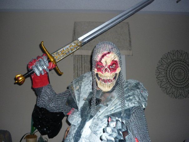

Step 2: Making the Finger Armor Plates
Cut your sheet metal into small bands that will form your finger/ knuckle armor. These can be done all at once or as needed. Try a few sizes and find one that fits your gloves / hand. It's also a matter of preference between simplicity and mobility. The smaller and more numerous your strips the more flexible your glove is, but it will take more time to do. I made mine 1.5cm - 2cm wide, and about 3cm -4cm long. Varying in size based on where on the finger they were going. I had 4 pieces per finger (1 nail, and 3 knuckles) except for the middle finger which had 5 pieces.
As I said before your best bet is to cut a simple rectangle, and bend it over your glove to see about how big it will be once it's in place and properly shaped.
Feel free to get creative with the plates, if you want to do engravings on them, paint them, or even put gold sparkles on them, it's up to you, just make sure they still fit on the glove, and you can still bend your fingers.
Be aware, I was building this with tin, and it has a nasty habit of forming razor sharp edges. I highly recommend dulling these edges somehow. I used a combination of sanding them + applying a clear coat of latex paint to the edges to avoid Edward scissor hand style gloves.
Once the plates are finished, (or as you finish each plate, depending on how impatient you are with assembly) drill two symmetric holes in the plates near the back edge. The back edge is the edge closest to your knuckle. The front edge being your finger tip. put two holes about finger width apart into the glove symmetrically on the center line of the plate. So draw a line or imagine a line down the center of the plate from front to back edge and then put the holes on either side of that line. Don't have to be exact, but it helps later on.
I was sticking each plate onto the glove as soon as it was ready ( as you can tell by the spent rivet shafts), because I couldn't wait to see how it turned out, but building your plates all at once will help with uniformity. I recommend doing one practice finger for sizing purposes out of paper, or cardboard, and then using it as a template for your metal plates.
I made my plates get slightly larger as they approached the knuckle, this is up to you, but I recommend doing it this way.
If you happen to have some kind of I don't know...35 Watt Epilog Zing Laser Cut / Engraver , you might be very tempted to adorn these little plates with some sweet artwork. Or Just precisely cut out to millimeter precision your plating pieces and their respective mounting holes. Just a thought, if any of you should have such a magnificent device.

Step 3: Making Your Plates Safe (Optional, Not Really Though)
If you've been using tin snips like I did, You've probably been left with some fairly dangerous edges on some of your finger plates. They can easily scratch things, and people, but they are also be able to cut, similar to paper cuts.
****UPDATE*****
A lot of people have been telling me to just file them down with a hand file. I fully sanction this course of action if you have the skills and a file. I did not do this in my case because I was building them inside of an apartment and I didn't want to worry about metal dust going into the carpet / air. I don't know if this is a realistic concern or not. But I suggest wearing a ventilator mask if you're doing any power sanding.
The way I made them safe was to coat the edges with a latex based verathane. I got a tiny can @ a paint store for $10, and I barely used any of it, a 50 ml bottle should be more than enough for your entire glove.
A cheaper solution is white glue, but I find that it doesn't work as well.
Dip your brush in your verathane, and then wipe most of it off so that you don't have any big globs on your brush, and then run your brush along the edge of your plate so that your brush and the plate make a ' T '. Most snips leave a slightly serrated edge, the verathane will quickly fill all the little bumps. Wait for it to dry and then add another coat. Keep coating it until the edges are no longer sharp.
It'll usually take no more than 3 coats to form a thick enough layer to make the edge safe.

Step 5: Riveting the Plates On
Before doing this, you may want to read up on how rivets work. They're really simple to use, but you have to be fairly precise when using them, because there's no undoing rivets. Once it's in, it's in. It's possible to remove rivets by drilling them out. Just use the same size drill bit as the hole and just drill through the center of the rivet, it should come out.
Basically, you put a hole the size of the rivet into the sheet metal, and into the glove where you want to attach the piece of metal, then you load the rivet into the riveter, stick the tip of the rivet through both holes, and then crank the riveter. It pulls a ball through a pipe which causes the pipe to expand. The expanding motion prevents the rivet from passing back through the hole.
Try riveting two pieces of sheet metal together before trying it out on your glove.
When ready to actually rivet the plate onto the glove there are 3 mini steps.
1. Place the plate, and punch/drill the holes in the glove
2. Place a washer inside the glove, take the rivet and skewer the plate then glove, then a washer on the inside of the glove. This is the most awkward step, depending on how good you are at maneuvering a washer into a finger hole without being able to see and horse shoeing it onto a rivet tip.
3. Crank that rivet until it snaps.
1) Placing the plate is a total preference thing, depending on the plates you've made, and how you want them to feel. I placed the glove onto a block of wood, then placed the plate on top, marked the spots on the glove with a nail/marker, then punch out the hole in the glove. If you're lazy, you can drill through the plates right into the glove, but I don't recommend it. Using a punch creates a cleaner hole, creates less mess, and doesn't require any electricity (Perfect for fabricating on the bus!). For the look that I wanted (cascading scales), I started first with the nail, and then worked my way back to the knuckle overlapping the pieces as I went.
2) I first stuffed both rivets through the plate, they fit tight enough not to fall out in my case. Then placed the plate loaded with both rivets over the glove and fed them both through. Then I placed a washer over a rivet, and riveted the washer to the glove and plate, and repeated for the other side.
3) Rivets work by pulling a wedge through a tube, causing the tube to expand, this expansion stops the rivet from passing back through the washer. Basically you keep pulling the wedge into the tube until the shaft connected to the wedge breaks. It guarantees a very tight seal, and it's a fairly reliable connection. If You accidentally apply a rivet to the wrong hole, it's not coming out. You'll find that once you're done riveting you'll have a ton of little aluminum sticks left over, keep these. They're a great source of pure aluminum if you or any of your friends are into smelting aluminum to make stuff. They can also be used as heavy gage needles, or pins. (I'm trying to be green here) I kept mine and I'm going to melt them down, and cast them into a charge of some sort.
Once your plates are riveted on, bend them into the appropriate shape. The tin I used was easily shaped by hand. I was able to just fold the pieces over the finger, and they all kinda worked out. If you attached some plates crooked, you can kind of tug them into the right orientation.

Thumb is very similar to the fingers except that it bends the other way, and you'll want to place your plates accordingly. Make sure that your plates don't interfere with your grasping. It's cool to have a scary spiky glove, but it's a lot cooler to be able to hold a drink in your hand without slicing the Styrofoam cup to pieces, because you've got spikes and blades sticking out of your thumb.
My spiky finger nails are a little bit of a hazard, but I toned down my thumb, so I can still hold cups and pick things up without scratching and cutting everything. You'd hate to ruin the finish on your sword hilt by scratching it with your gauntlets.
Step 11: Finish It Off
I didn't have time to finish the gauntlet, but I'm going to try to dye the glove black. I will also potentially add some paintings to the plates. I'll add some photos if it works out. If it doesn't then I'll claim I forgot or something...
Good luck with your projects, I will eventually be posting instructables for the rest of my suit of armor. But don't hold your breath, these things take a while. If you guys have any suggestions please comment, I'll add them to the instructable!!
