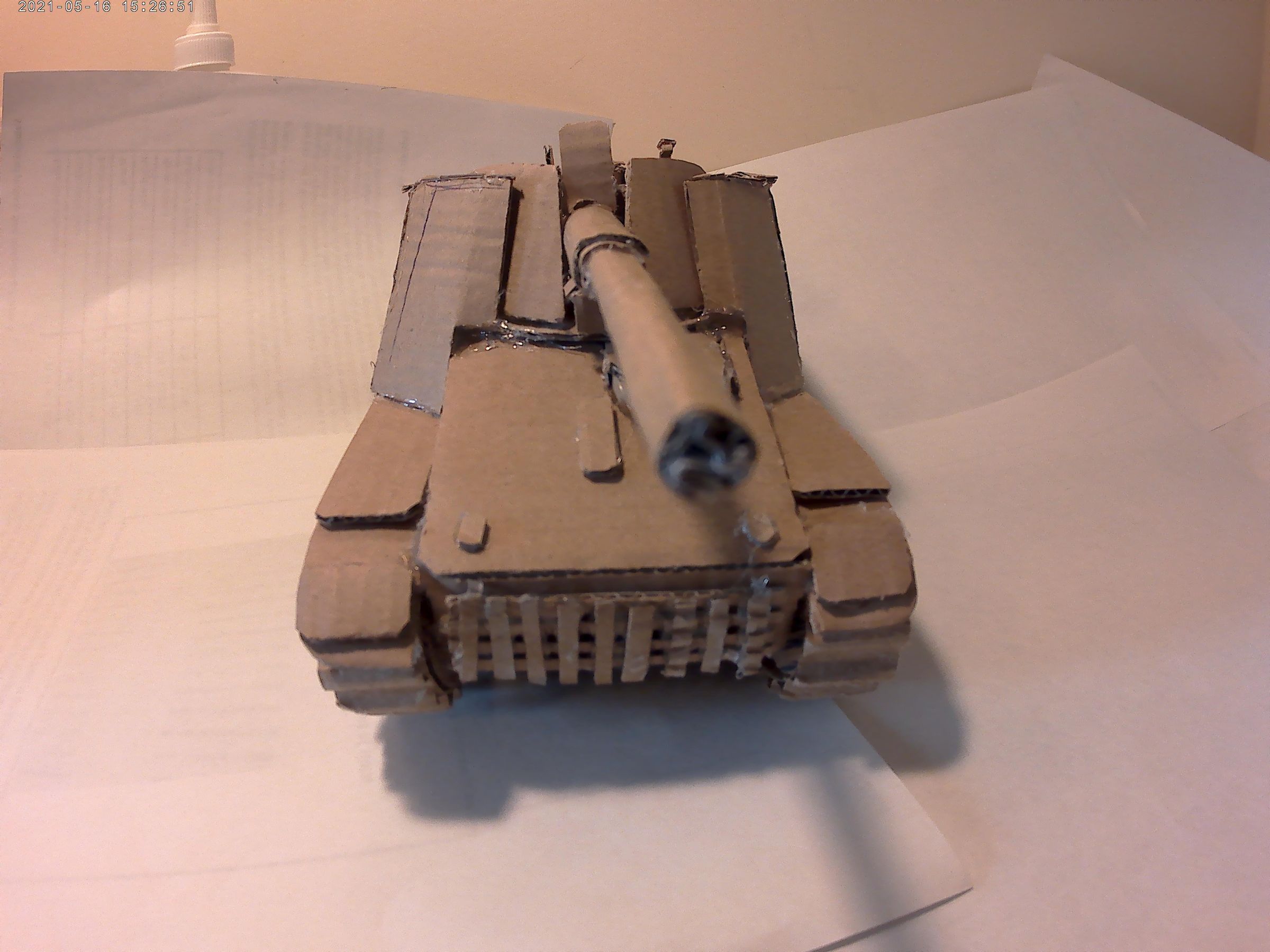

Step 3: Building Up the Subassemblies
Here is where the bulk of the work, and the magic, happens while building a papercraft vehicle. Several examples of buildings and other vehicles are shown in the pictures provided, all using the same methods. After cutting out and folding parts, apply angle/thicker card reinforcements, and laminating details.
As mentioned above, keeping thicker and thinner card/paper stock available helps incredibly with detailing. Outside of folding sheets to create 3D polygons, I have found that layering materials really enhances the build. Laminating a paper card hatch to a cereal box before cutting it out really allows it to stand out from the hull or turret of a tank/APC (armored personnel carrier) for example.
If not painting, applying marker (or colored pencil) to exposed edges (mountain folds included) of the paper/card stock is critical, now is the time to accomplish this! Once again, use that burnishing (ball end tool) to the widest extent possible to create all your folds (I've mentioned this in every section for a reason!).
Step 4: Greeble and Detailing Subassemblies!
By far, this the where you become the artist and take your models to the next level. The pictures all come different models than the vehicle I started out with, but show the variety of details achieved by the use of common items. From tooth pick pieces, to hemispherical nail art beads, to just added layers of cardstock and solder CA glued to the walls to look like wiring conduit. Masking tape makes great belts and tie down straps when you cut it into thin strips. Good PVA glue can be used, stippled with a toothpick, to create rivets for those steampunk/gothic science fiction vehicle projects. Dowels cut to length provide a solid shaft for turrets, as well as a good form to wrap paper tubes around for cannon barrels, axles, and other cylinders.
You are only limited by imagination, and what might fall apart on you too many times to continue trying (if you frustrated, STOP, do not throw the model across the room... Trust me, you will regret doing so every time... not that I have any personal experience or anything). One great thing about papercraft models is that you can always print spare parts, allowing you to build the same over and over again when needed.
