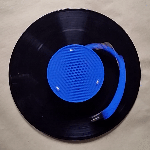

Step 4: The Tonearm:
Update: as seen in pictures I have now started testing a new tonearm design.
This is the part I'm having the most problems with.
This original design worked in my testing phase but with everything assembled it played only a certain section of the record and skidded on the outermost and innermost sections.
I'm currently working on a way to extend the arms length without adding a lot of inertia whilst spinning. I now have two arms, the first one extends out and locks into place and then the second arm moves freely on the end of the first.
I also want another way to adjust the tracking weight.
Now for the cartridge holder.
After printing I used a 4mm drill bit to enlarge the hole on which the holder will pivot on (it is printed with a 2mm hole otherwise it will be impossible to print except if you use a SLA printer).
Now cut off a 6-7mm piece of teflon tubing and press it into the hole, this should give you a nice slippery bushing.
An easy way for me during testing to adjust the tracking force was to use a piece of 4mm bronze rod with various sizes of ball bearing brazed on top of it that can then be pushed into the top of the holder and also acts as a knob to pick up the stylus from the record.

Step 10: First Test:
Here we go....
I would suggest you start without the cartrige just to make sure all the main components work.
Next you will use the potentiometer to adjust your speed
My first attempt was a success until here, the drive and Bluetooth transmission works perfectly but unfortunately like I mentioned earlier the player does not want to play the edges of the record and skids.
Tip: Always use a cheap unwanted bargain bin record to test on!
