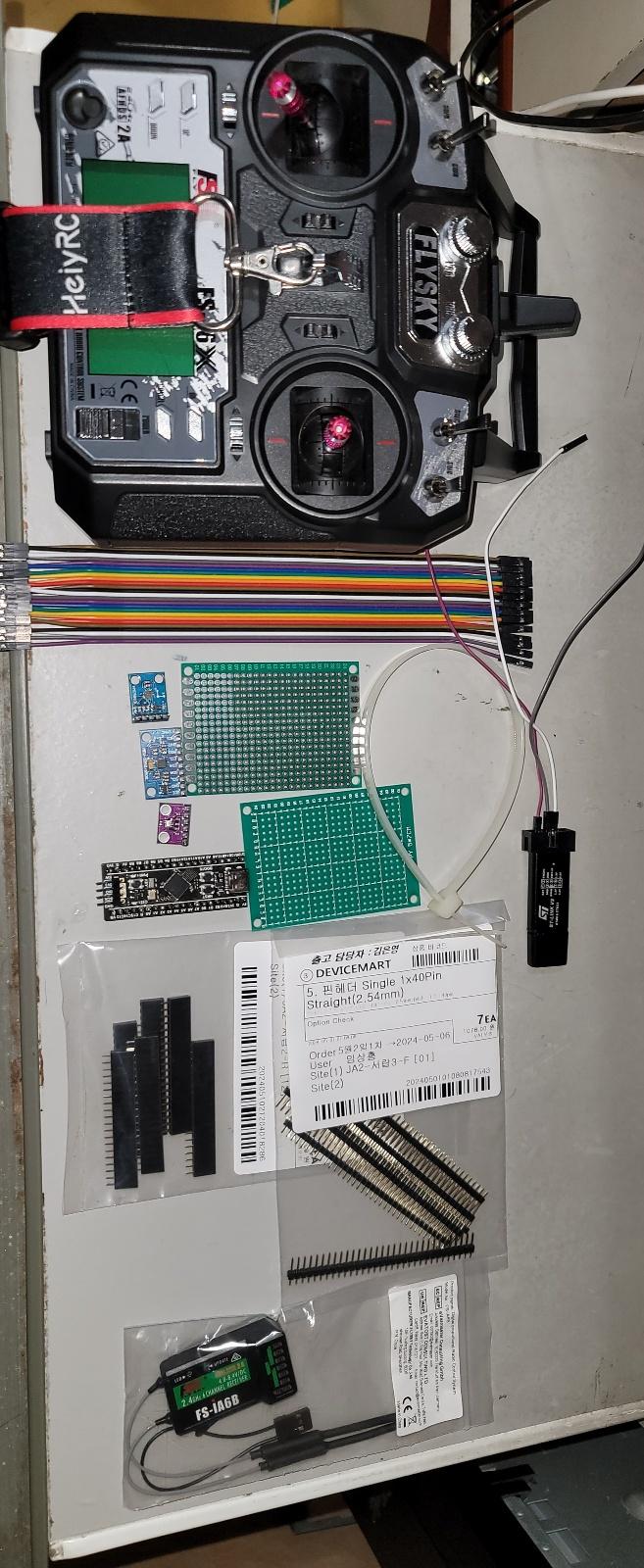

◇<Parts used>:
1.STM32F411CEU6
2.Jumper cable male/female
3.PCB soldering board
4.hmc5883L (compass magnetometer sensor)
5.mpu6050 (acceleration gyro sensor)
6.BMP280 (barometric altitude sensor)
7. Pin header (female/male)
8.FS-1A6B (Receiver)
9.FLYSKY remote controller
10.Cable tie
11.ST-LINK V2 Downloader (for STM32)
12.GPS_NEO6M
12.at2212 brushless motor
13.ESC 30A
14.1045 Propeller
15.F450 drone frame
16.Lipo battery 11.1v 2200mah or 1500mah
17.Lipo battery charger
Step 1: Creating a Control Board
with the above parts Connect the wires to each component according to the circuit diagram in the photo.

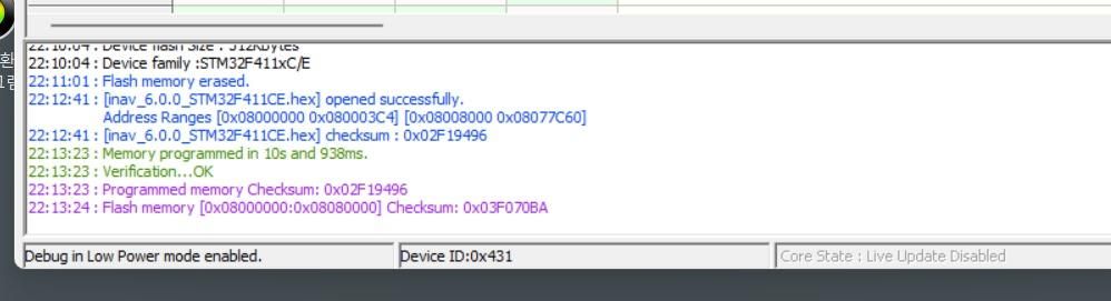

Step 6: Upload Firmware
Connect the STM32F411CEU6 board to the ST_LINK V2 downloader.
Connect the ST-LINK downloader to your PC. Run the STM32 ST-LINK UTILITY program on your PC.
Run the program, set the correct port for the connected device, and establish a communication connection.
And <INAV drone source code HEX file>
Enter the STM32F411CEU6 board memory
Inject.
<Reference video>:
https://youtu.be/W4jgK8oeTN0?si=_YhpoAIbdrPcWuVf

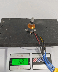

Step 11: Measuring Drone Weight
Now the last step you need to do is
The lift force (kg) that a drone can currently generate is
How many and how many items can you lift?
Raise it? no see.
The picture shows the motor used in the drone.
This is an experiment to measure lift (the force of flying).
※Here, AT2212 1000KV for drone motor
You can see the text written on it.
AT2212 is the motor product name and [1000KV] is
The voltage required to rotate the motor is not 1000KV,
It means <1000 rotations per minute at 1 volt>.
■The lift that one drone motor can generate at maximum voltage is 707g => 0.707kg.
Since there are 4 motors used here,
Total generated lift is 0.707kg x 4 = 2.828kg
no see.
■Drone weight is 884g => 0.884kg
■[Weight limit that a drone can lift]:
Total generated lift - drone weight = 2.828-0.884
=1.944kg
This completes the drone production.
Step 12: Enjoy^^~
