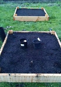

Step 19: Completed
You have successfully built a raised garden bed. Ready
for planting. These garden beds are easy to build and easy to keep. The cardboard eliminates the hassle to have weeds in your garden bed.
