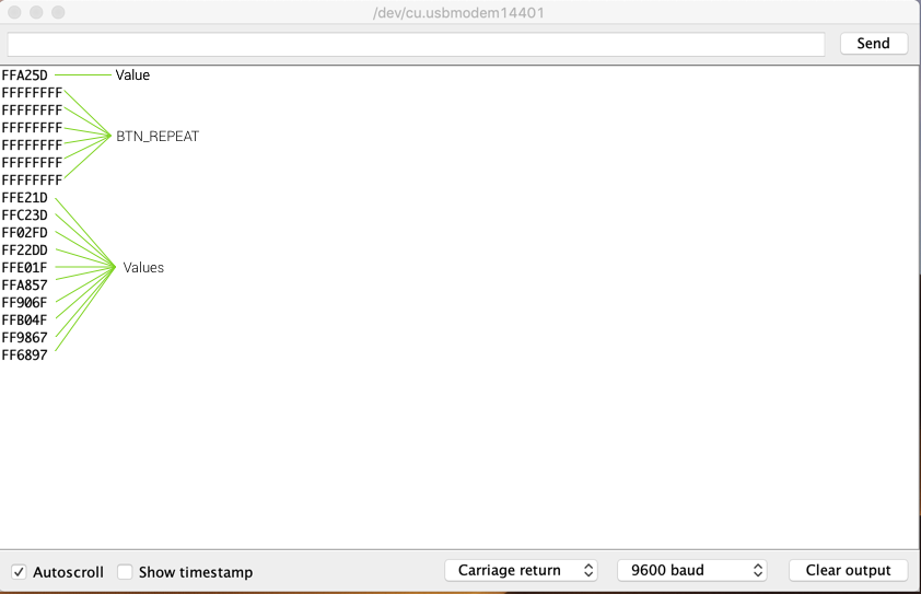

Wire up the circuit shown in the picture above using one of the infrared-receiver chips, upload the IRrecvDemo example sketch to your Arduino and open up the serial monitor.
Then use your remote and press the buttons you want to use. Every button-press should display a certain hex-number. If you hold dow the button, a different hex-number should repeat.
First, copy the value of the repeating hex-number and change BTN_REPEAT to that value. Then work through the defines in the code and change all to match your remote. Make sure that all values must begin with 0x to be recognized as hex-number - so only change the highlighted part of the number.

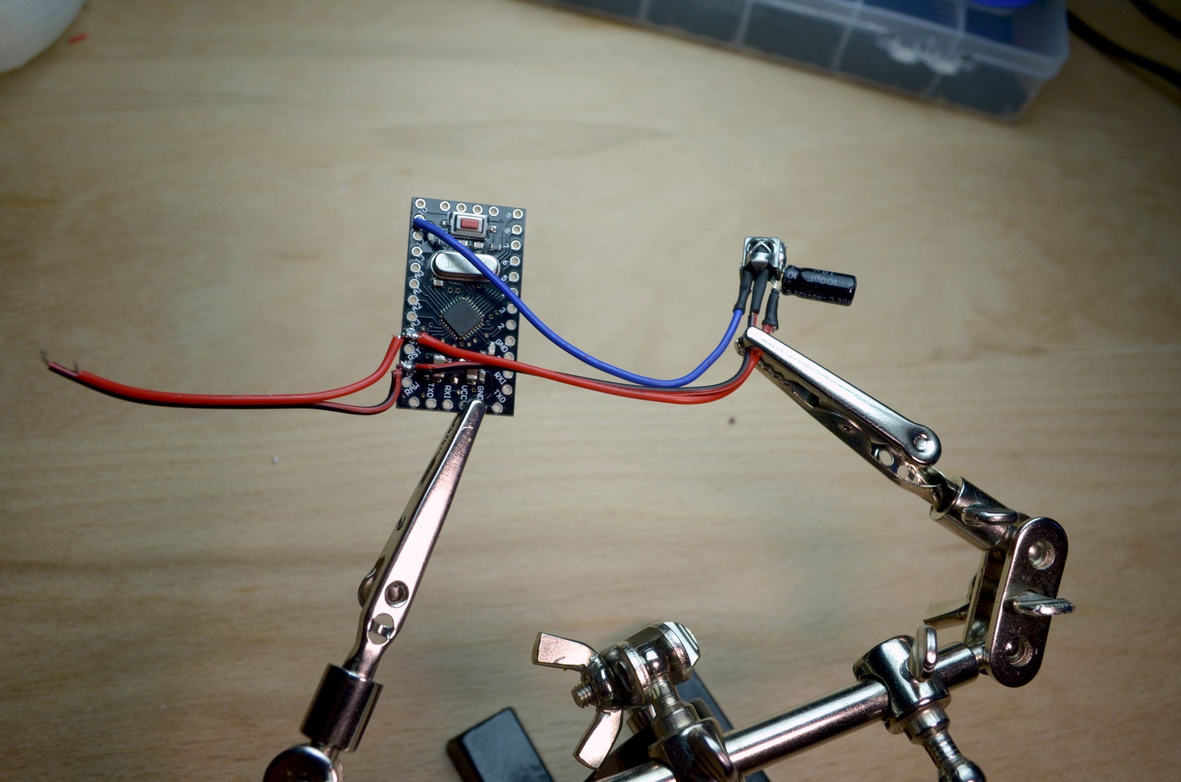

Step 9: Soldering: Arduino, Leds and Sensor
Next we have to wire up the Arduino, IR-Sensor and LED-strip
The Arduino gets wires for VCC and GND
The Infrared-Sensor is a bit more tricky: First we need to connect the capacitor as close to the sensor as possible. Since the housing of the sensor is grounded, we simply solder the capacitors negative leg to the housing the and the positive leg to VCC wire. Next we wire up all three pins and isolate them using heat-shrink-tube.
For the LED-Strip we first cut off a piece of strip with 10 LEDs. Then we solder wires to all 4 contacts.
Step 10: Soldering: Putting It All Together
The next step is to trim the wires as short as possible and connect all modules together.
We start by trimming the Arduinos power cable by placing it and the boost-module inside the case and trimming the power cable to length.
Next we repeat the same for the Infrared-Receiver.
The cables for the LED Strip can be trimmed without measuring since we have enough space to keep them a bit longer.
We can then solder the infrared-receivers power cables directly to the pins of the Arduino and its data-pin to pin 11 of the Arduino.
Next we solder the data and clock cable of our led-strip to the Arduino. Connect the clock cable to pin 5 and data cable to pin 6.
The only thing left to do is connect both the Arduinos and the led strips power cables to the output of the boost module.
