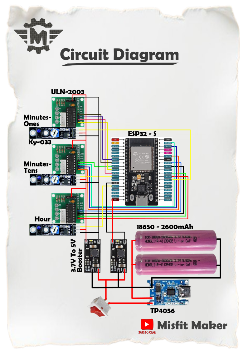

How this clock works: This TRI-belt clock uses an ESP32 microcontroller to display time by moving three belts—hours, tens of minutes, and ones of minutes. Each belt is driven by a 28BYJ-48 stepper motor through a ULN2003 driver. A TCRT5000 (KY-033) infrared sensor is placed on each belt to detect its home position, ensuring accurate alignment. The ESP32 connects to WIFI and retrieves the current time using NTP (Network Time Protocol). Based on this time, the motors rotate the belts to the correct positions, using calculated step counts for precise movement. The system also performs periodic auto-homing to maintain long-term accuracy and prevent drift.

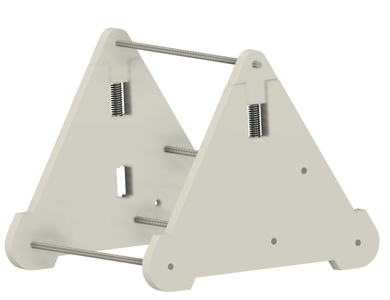

Step 3: Making the Belt Tensioner
For smooth belt movement—and to ensure the drive pulley gets a firm grip—you’ll need a belt tensioner. I used a small spring with a 5 mm outer diameter, which you can easily salvage from almost any click pen. Just make sure the spring has enough stiffness to hold up under continuous use.
To support the spring, I used a 3 mm rod and glued a matching 3 mm washer into the slot base to act as a stable platform. The setup is simple and effective, as shown in the images.
Step 4: Making the Partition Panels
Next, we’ll assemble the middle partition panels that support the stepper motors. Each partition is made of two pieces—one main panel and a shorter piece that gets glued to it, as shown in the images. Before gluing, position the shorter piece so that its base sits exactly 35 mm above the base of the larger panel. This spacing is important for proper alignment, so take a moment to measure before committing with glue.
For mounting the motors, I used M3 nuts and bolts. I had to grind down the heads of the bolts; otherwise, they’d bump into the moving gear and disrupt its rotation. Once trimmed, I glued the bolt heads onto the foam board panel. These embedded bolts will later serve as the mounting studs for the stepper motors.
I also created the necessary holes for the 3 mm rods in this step. For precise placement and dimensions, refer to the attached CAD model and templates.

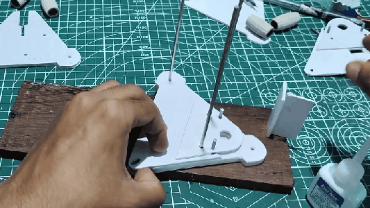

Step 5: Fixing the Rods
Now we’ll glue the 3 mm rods to the foam board cutouts, as shown in the images. To ensure the rods stayed perfectly perpendicular to the surface, I made a small alignment tool out of foam board—essentially a mini saddle square. It helped keep everything at a perfect 90° angle while the glue set.
Is this tool absolutely necessary? Technically, no. Foam board has a bit of flex, so you can get away without it. But small misalignments can snowball into major headaches later on. So why risk it? A quick, simple jig now saves you a lot of frustration down the line.

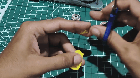

Step 6: Attaching the Bearings to Pulleys/Rollers
This step continues our pulley work from step 1: we’ll be attaching the bearings to the pulleys we made earlier and gluing the pinion gears onto the drive pulleys, as shown in the images. The bearings are simply press-fitted into the pulley/roller for a snug and secure fit.

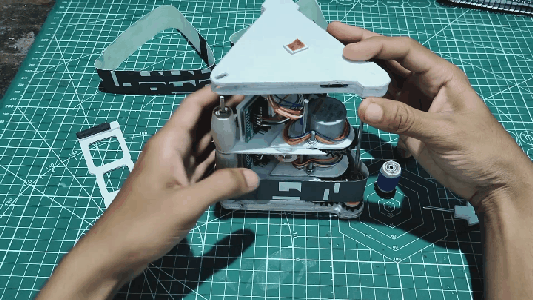

Step 7: Attaching the Partition Panels
Now we’ll position the partition panels using the spacing specified in the CAD model/templates(31 mm for the minute sections and 34 mm for the hour section) as shown in the images. After that, glue the spacing cutouts in place; these will later serve as the mounting points for the KY-033 sensors which we attach them with a glue gun.
While gluing the spacing cutouts, I intentionally secured only one side of each cutout to the partition and left the other side free. This simple trick makes disassembly far easier if you ever need to troubleshoot or tweak something later.
Once the partitions are aligned and fixed, I attached the side panel. Any excess rod protruding beyond the panel was then trimmed off using the rotary tool.

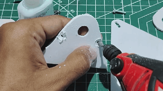

By “modifications,” I’m referring to the small adjustments made to accommodate the electronics inside the foam-board body.
Since the TP4056 charging module has built-in charging and charged indicator LEDs, the light wouldn’t be visible through the 3 mm foam board. To fix that, I shaved a thin section of the foam board above the LED area using a rotary tool so the light can pass through.
Next, following the provided templates and CAD model, I made the necessary cutouts and holes for mounting the mini rocker switch and the ESP32-S. The 3.7 V-to-5 V booster module is secured to the panel using double-sided tape, as shown in the images.
All components were soldered according to the circuit diagram included in the supplies section.

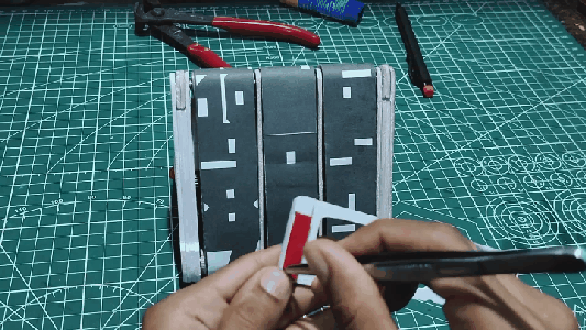

Step 10: Making the Belt
I’ve created two styles of numbers for the belt: a cryptic version and a standard version. Why two? When I first showed the clock to friends, the cryptic digits were a bit puzzling—it took a moment to decode the pattern. To make the build more beginner-friendly, I included a normal-number version in the same template.
The choice is yours: cryptic for a futuristic, mysterious aesthetic, or normal for easy readability. Personally, I prefer the cryptic style—it just has that sci-fi vibe.
Once you’ve chosen your style, print the template on A3 paper and carefully cut out the belt pieces with a craft knife. To strengthen them, reinforce the back of each piece with masking tape, as shown in the images.
To set up the home position, the IR module needs a high-contrast mark—a black strip on the white belt. I used a piece of black PVC insulation tape for this.
My clock’s home position is 1:00, aligned as follows:
  1. Place a small piece of PVC tape just before the “1” on the hour belt.
  2. Arrange the minute belt pieces so the display reads 1 0 0 when viewed through the front plate.
  3. Once aligned, mark the corresponding position on the minute belts with a pencil, then stick the tape.
This ensures the black reference marks on both the hour and minute belts line up perfectly at 1:00, allowing the IR sensors to detect the home position accurately (as shown in the GIF).
