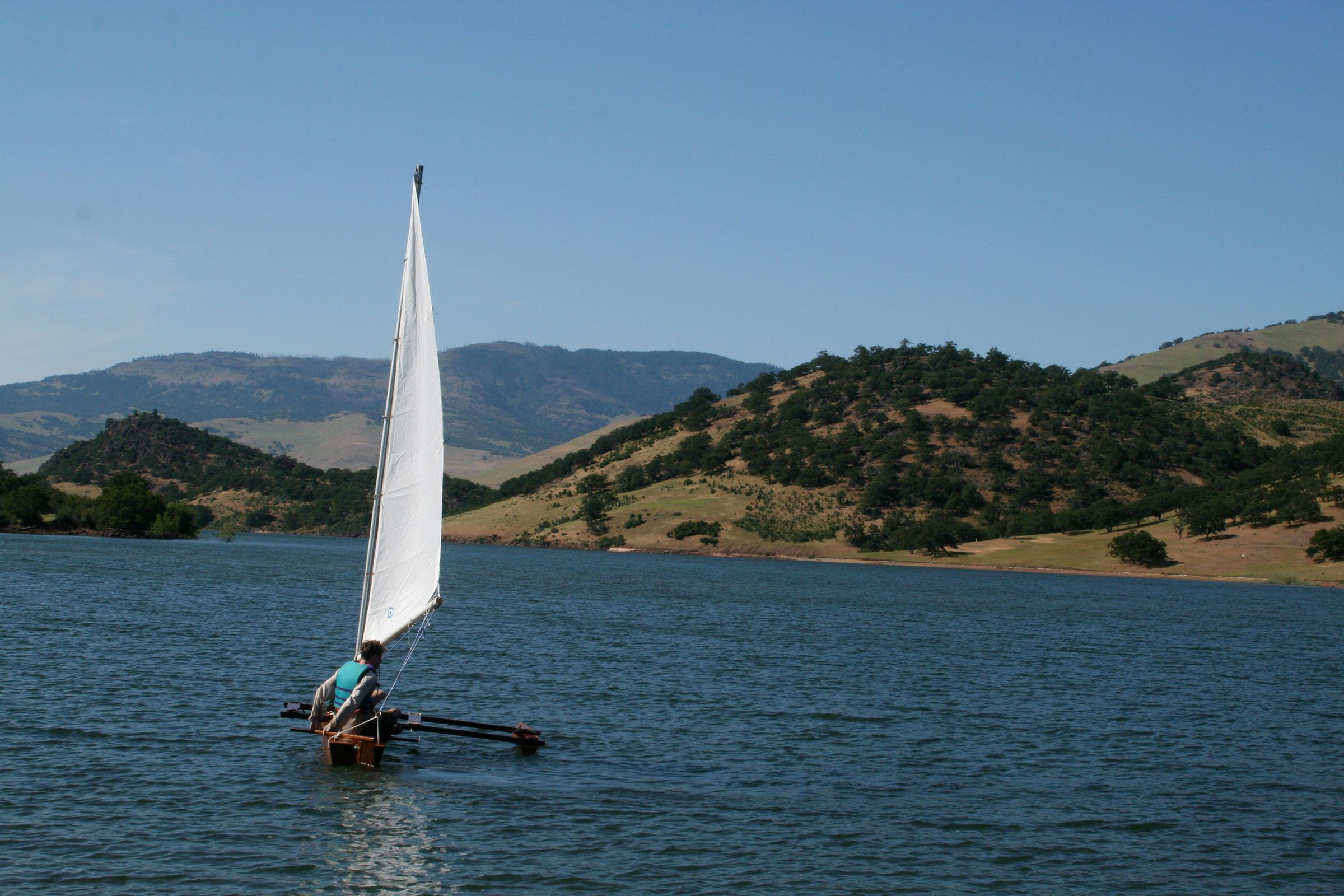

Step 6: Get Distracted and Build Another Boat
If your boat is taking too long, it is suggested that you build a second boat in the meantime. Pictured is the spine for a westernized westernized Proa we accidentally built one summer.
