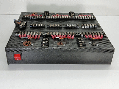

Step 2: Building the Chassis
I selected this case cover from my hoard of materials for its dimensions and shape. The sheet metal is very thin, just 0.7mm, which makes it very easy to work with. The perforated area facilitates centering and fixing of the components.
That perforated area has plenty of room to fit two miniature sockets, two novals and two octals, plus the terminal blocks to give access tho the socket pins, plus few extra blocks for components connections, line power and ground.
The making process was very straightforward: The cutting, drilling and bending areas were traced on painter's tape.
The corners and the rectangular holes were cut using scissors and a small grinder. The large holes for the tube sockets were drilled with hole saws.
The smooth areas were folded down to create a box-shaped chassis.
A couple of rivets at each corner give rigidity to the whole.
A layer of epoxy covered the corner seems and other imperfections.
Once the epoxy cured, it was sanded smooth and a quick spray of paint was applied to give it a nice finish.
The resulting chassis measures 320mm long x 290mm wide x 65mm high.

Step 4: Assembly and Wiring
Once the chassis was built, the components were fitted into place.
On the front plate, the power switch was inserted. On the back plate, the power socket and the fuse.
At the top, the tube sockets were secured with M3 screws and nuts. The terminal strips were fixed mainly with self-tapping fasteners, except at those ends where the end terminals were connected to ground.
The colored cables were screwed to their corresponding arranged by the numerical color code (the same of the resistors).
-Brown = 1
-Red = 2
-Orange = 3
-Yellow = 4
-Green = 5
-Blue = 6
-Violet = 7
-Grey = 8
-White = 9
The wires passage through the chassis was protected using shrink tubing and cable ties, these wires were soldered to the corresponding socket leads.
Finally, the power circuit and ground cables were installed.
At this point, the project is completed, now it's time to do some tests.

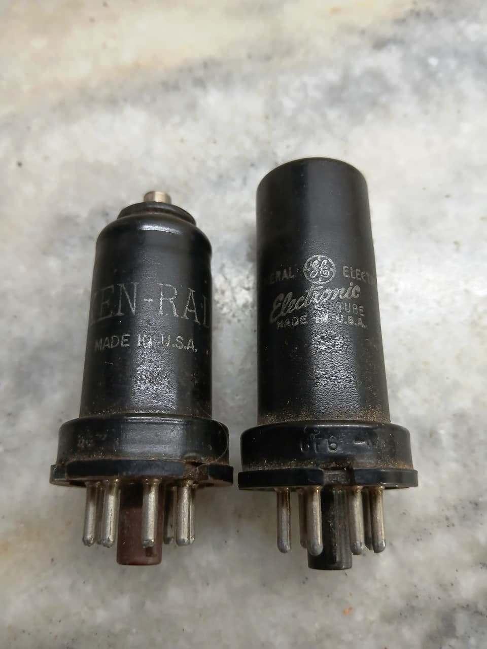

Step 7: Testing Valves
Valves have a finite life span by nature, the cathode emission decays over time to a limit where they are no longer operational. Also, because valves are assembled using multiple small parts with intensive handwork, they can often fail due to mechanical causes such as insulation leakage, short-circuits from loose particles or vacuum loos due to cracks in the envelope seal.
That's why it's necessary to test valves, for example to repair a malfunctioning device.
Today, you can still purchase valves on the market, both brand new (yes, there are still active electron tubes factories around the world), new-old-stock or used. You may need to test these valves to check they are of the quality claimed by the vendor or to create matching pairs where required (e.g., push-pull amplifiers).
There are several types of valve testers, both vintage, new or DIY.
Almost all of them can check gas intrusion, insulation leakage, noise, emission, transconductance, etc.
I don't have a valve tester (not yet), so this is a good opportunity to improvise some basic tests on the prototype board:

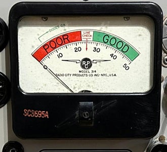

Step 8: The Emission Test
Emission test is one of the simplest ways to check a valve's condition. It consists in apply a preset dc voltage between the cathode and the plate with the grid, screen and other auxiliary electrodes connected to the plate, and measuring the current using a milliammeter.
Such instrument has its scale plate marked with a green and a red zone in a Pass-Fail fashion.
If the plate current is within the green zone, the valve is OK. Otherwise, it is weak, worn out or non-functional.

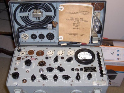

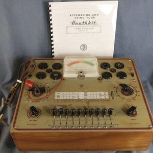

The first, second and third pictures show typical emissions testers and its milliammeter with its color scale.

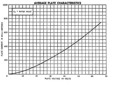

The valves of choice are three 6AQ5 in different conditions: One NOS, one very worn and a troubled one.
Applying 100Vdc, the NOS draws 21.44mA; the worn down, just 3.06mA and the defective unit runs almost 100mA under 20V!
Note that the NOS valve plate current should be around 30mA according to the curve shown in the photos. However, emission is within the acceptable range (barely). That's why it's necessary to check the valves when you bough them, even if they claim to be in mint condition.
Having said that, this a perfectly useful component.

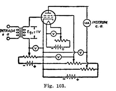

This time, I have built a transconductance test rig based on the figure taken from the RCA data manual.
The set up consists on wiring the valve under test applying preset voltages to each electrode according to the recommended working conditions in the datasheet. Then, by applying an AC signal to the grid, the corresponding AC current on the plate can be measured (this AC current is superimposed on the static DC plate current). The same variac-based power supply was used as in the previous test, the "San José" power supply provides the grid negative bias and another power supply feeds the filament with 6.3V DC. The DMMs display DC plate voltage and AC RMS plate current. The scope injects a 1V RMS signal into the grid and shows its amplitude and the grid bias.
If the grid signal is 1VRMS, the plate RMS AC current is equivalent to the transconductance according to the formula gm=Δiout/Δvin. Therefore, the AC mA reading multiplied by 1000 is the transconductance.
The test conditions are shown in the table taken from a typical datasheet. The valves chosen are two of the three 6AQ5 from the previous test (the failed unit was excluded).
The last two photos shows the test readings of the NOS 6AQ5 and the worn one. The new valve has a transconductance that nails on specs, 4111 micromhos/microsiemens, while the oldie reads just 1700 microsiemens (It will work on an amplifier, but the sound will be very thin).
