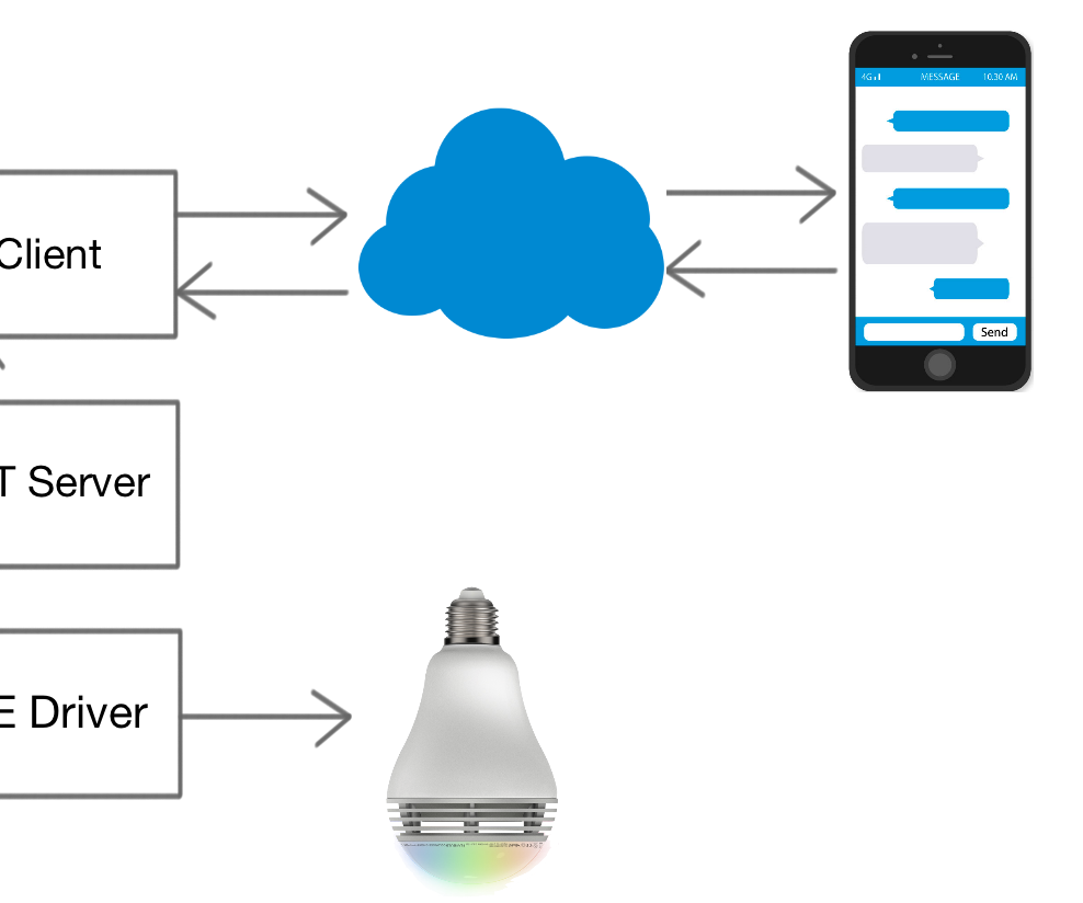

In this instructable, we will build a web enabled electronic door lock from scratch using RESTFUL API, Node JS and Raspberry PI to provide the web service consumed by the mobile app or any REST client.
The Architecture is divided in two 3 parts :
  1. The REST Server (NodeJS, express and pi-gpio) installation and configuration
  2. The Lock and Raspberry PI hardware connection (NPN-Transistor, 12V Relay ... etc)
  3. The Server application code to control the lock and publish the REST functions used by the REST client
  4. The REST Client (IPhone App)
