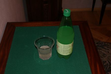

Step 3: Braga!!!
This is probably the most important part of your samogon. Without it you cannot make your moonshine.
This part is relatively easy. The recipes!:
1*)600 gramms sugar, 20 gramms yeast, 3 litters water: mix everything together & set in a warm place for a week.
2)600 g. syrup, 20 g. yeast, 3 litters water: see (1)
3)a can of tomato paste, bottle of beer, 1 kilogramm of sugar, 3 litters of water: mix ingreidients, let sit in a warm place for 4-5 days.
To make whiskey you need a braga made from mashed up barley (the process is much the same).
  • I used this one
