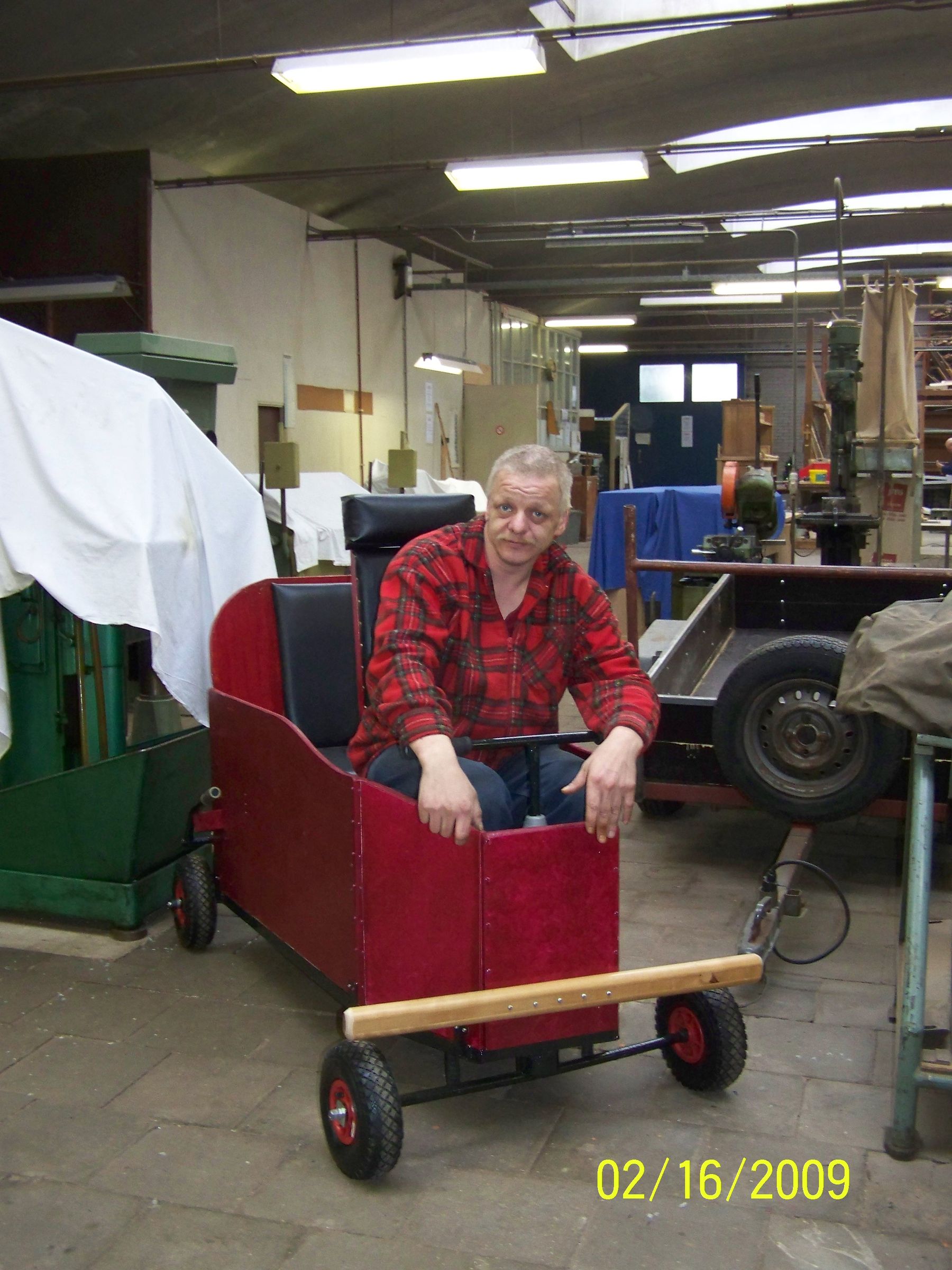

Right now I am building a transportation device so I can walk with the boat to the water nearby.
