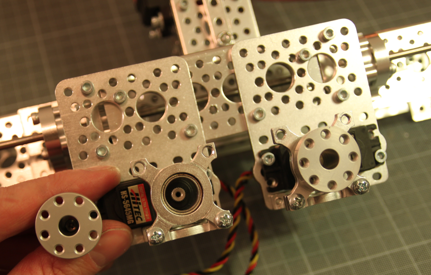

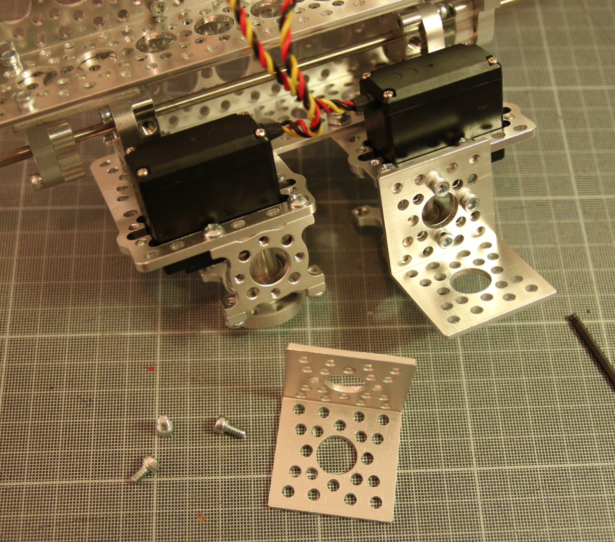

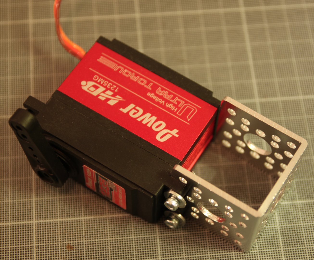

- Two standard size servomotors, I used two Hitech HS-5645MG.

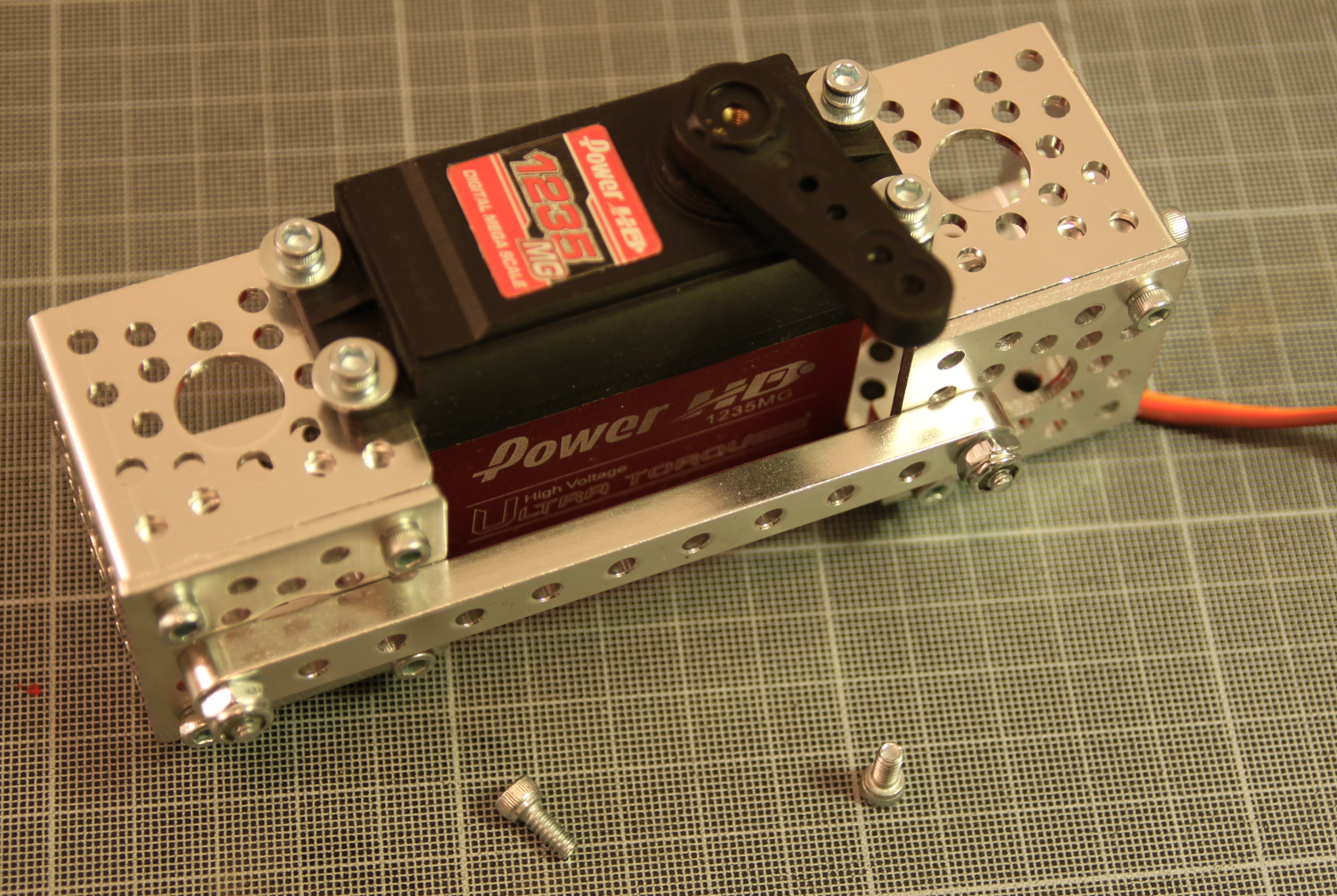

- A heavy duty, quarter-scale servomotor, I used a Power HD-1235MG.

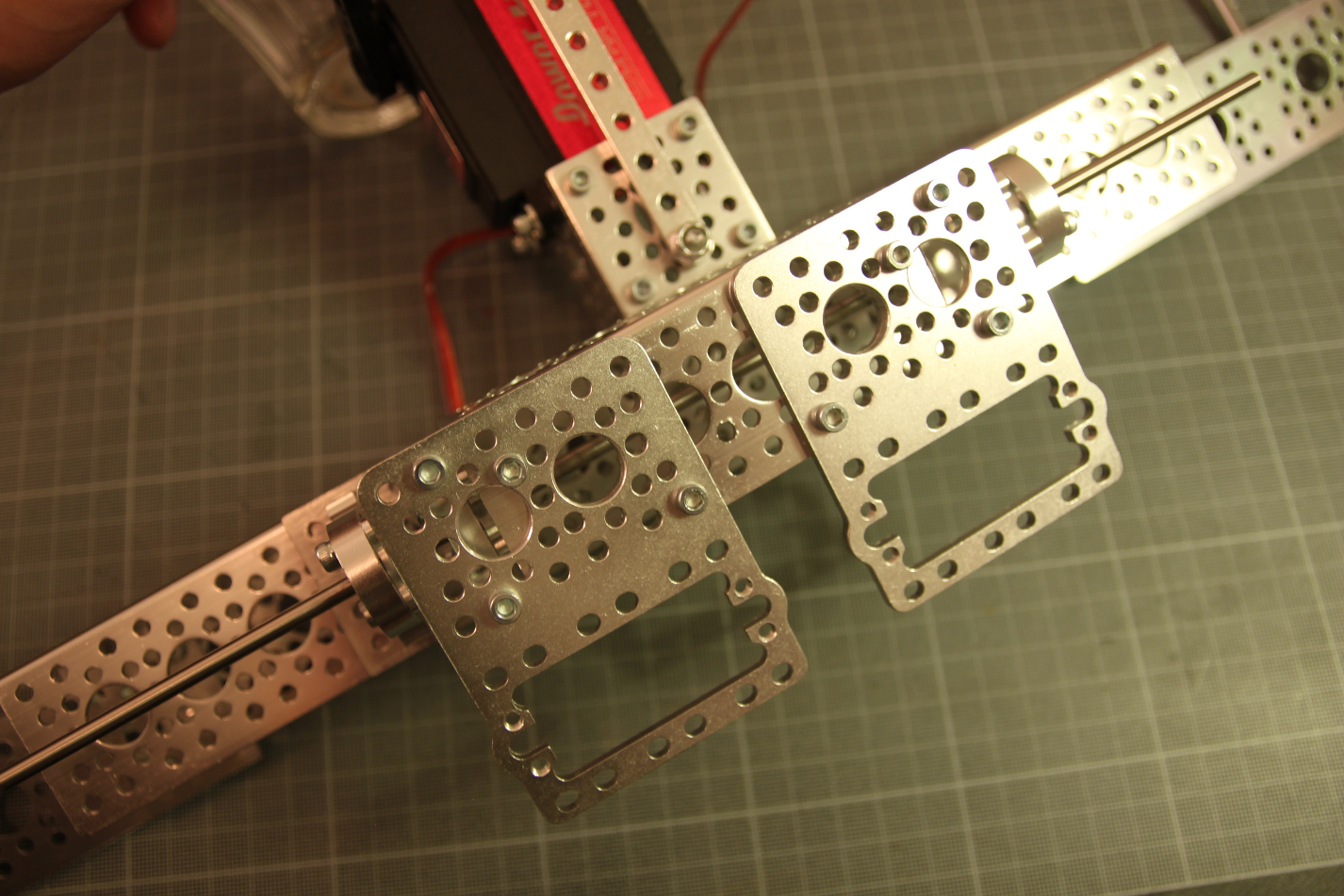

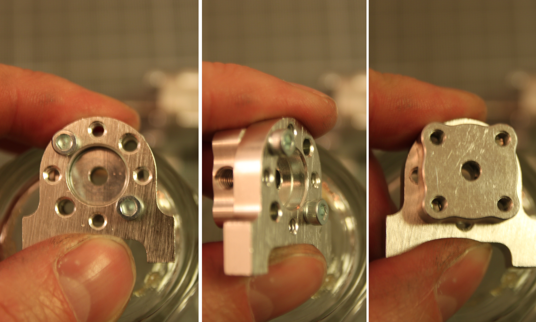

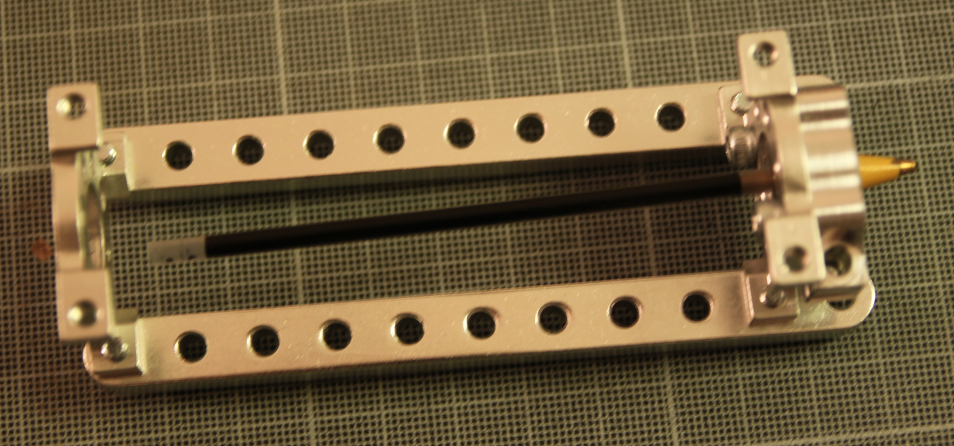

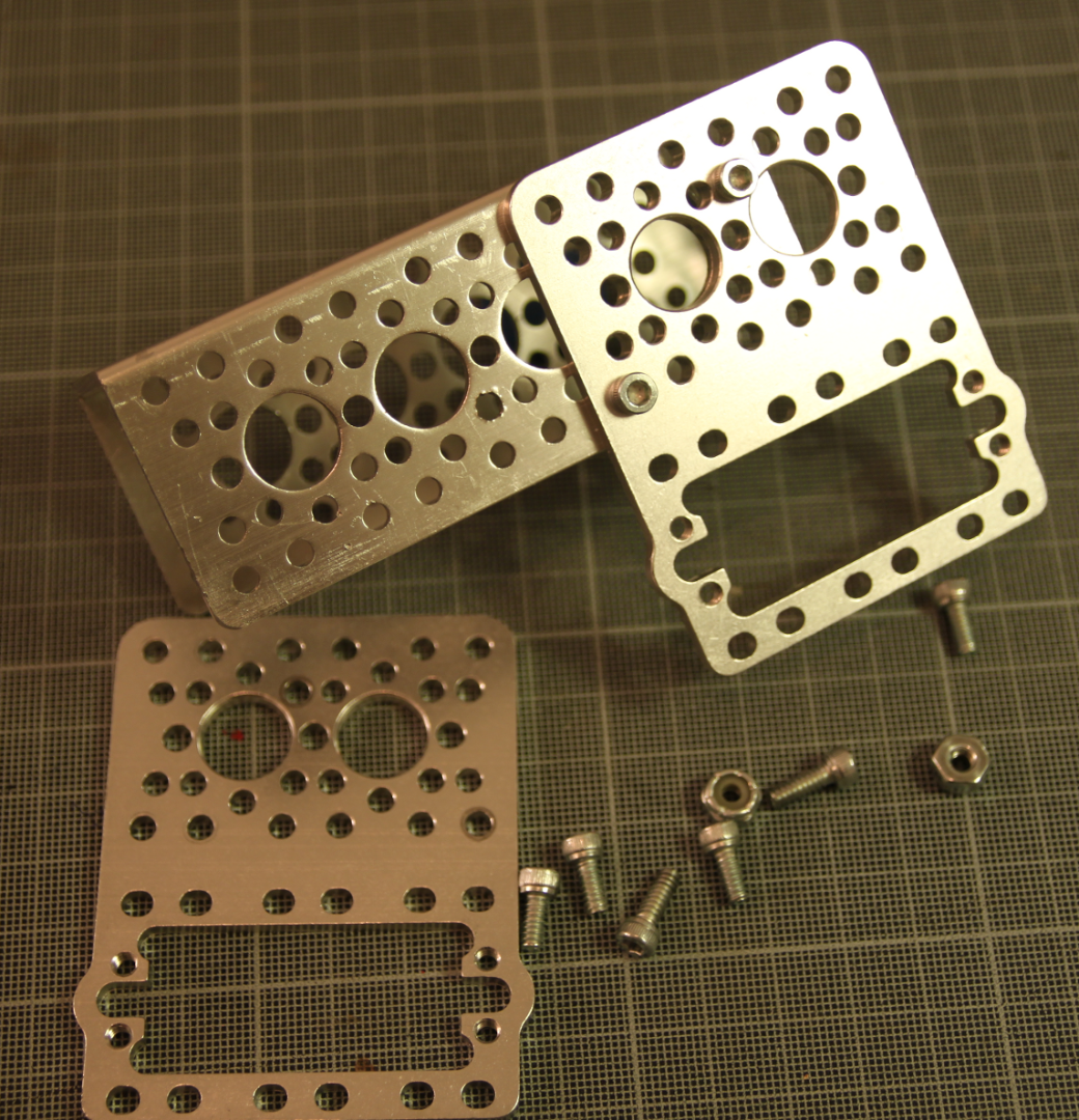

- Some mechanical hardware to build a frame holding the two servos, the two arms and the writing tool. I used Actobotics components and you will find a complete list of pieces I used in the Mechanism sections of this instructable.
- A breadboard and jumper wires for electrical connections.
- An independant DC current source for the servomotors (alternatively, use the one provided by the arduino board).
- A biro and a piece of wire (here I used a piece of bicycle brakes cable).

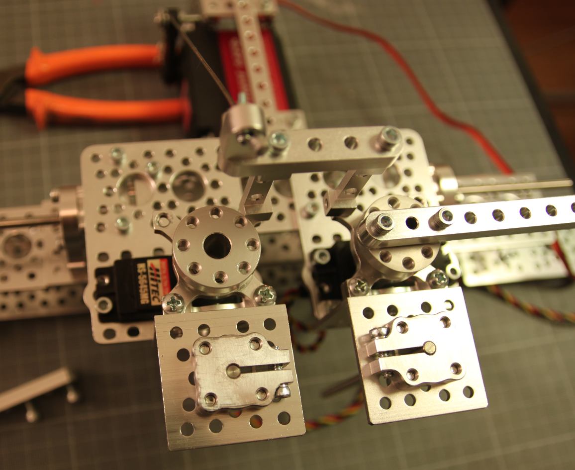

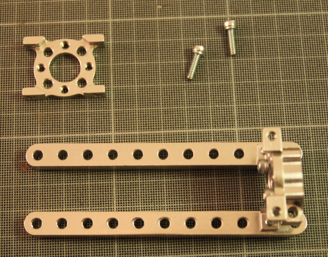

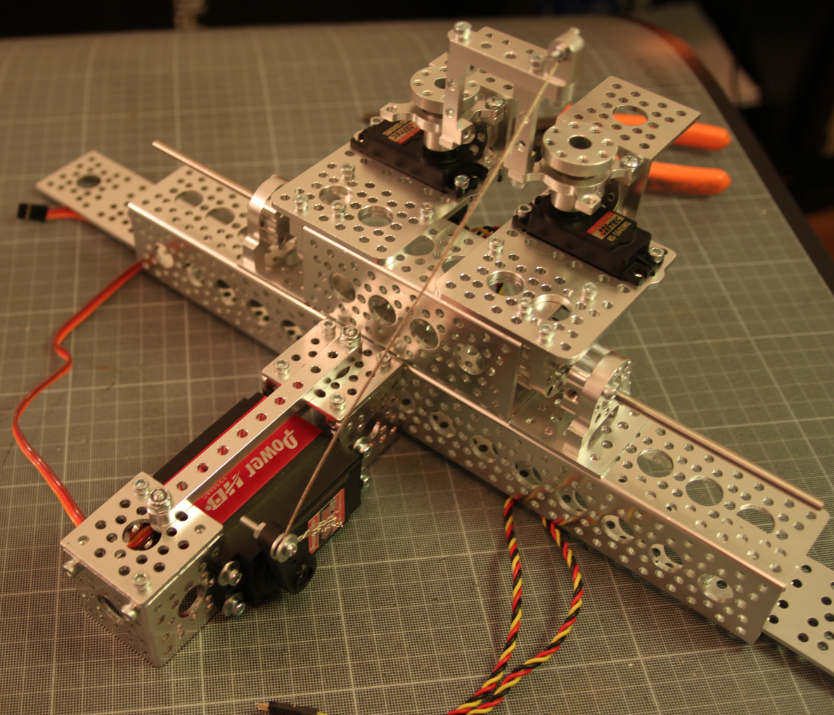

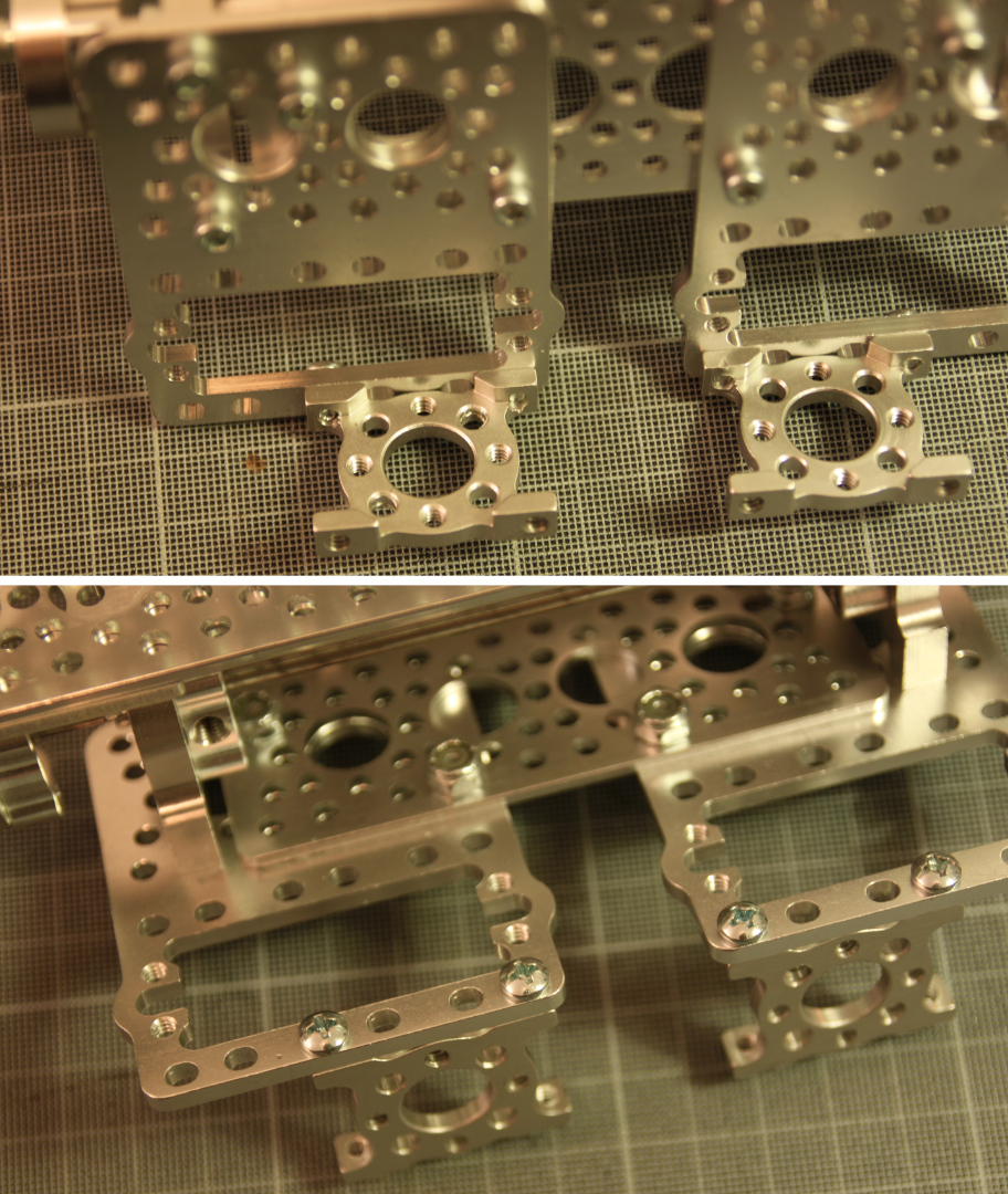

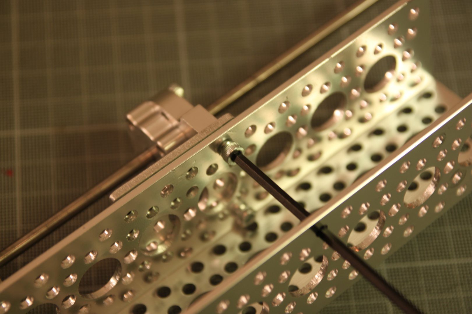

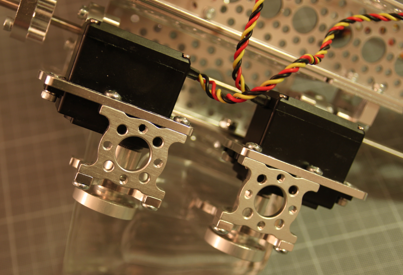

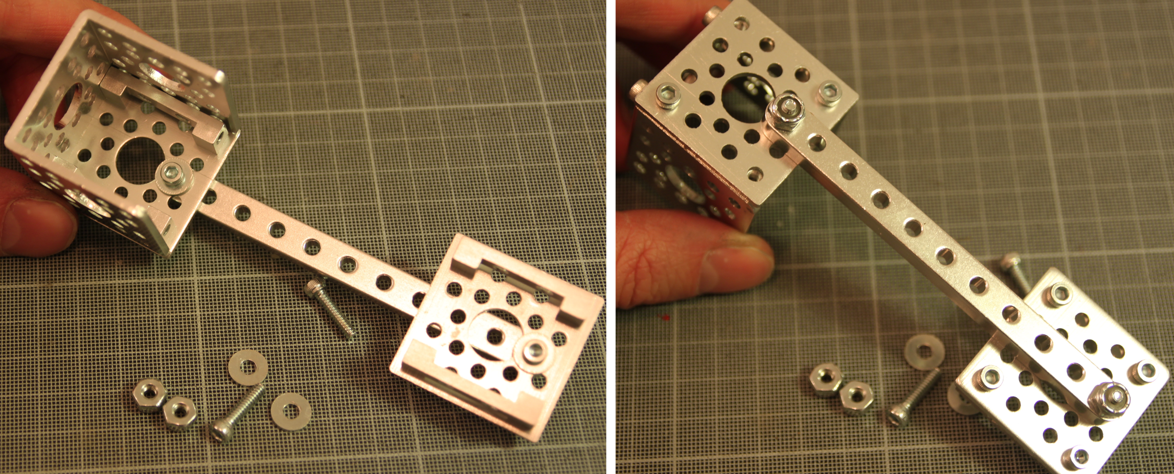

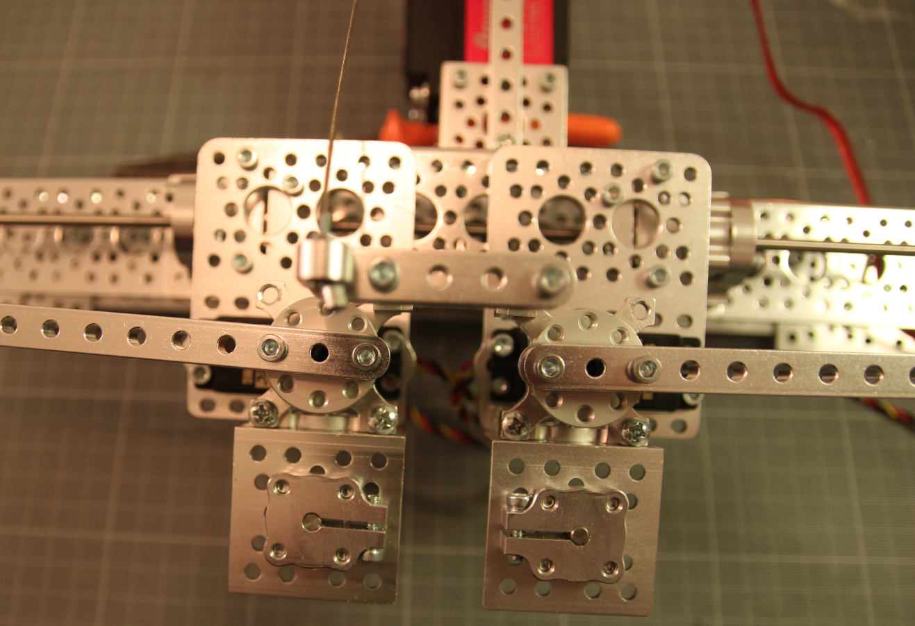

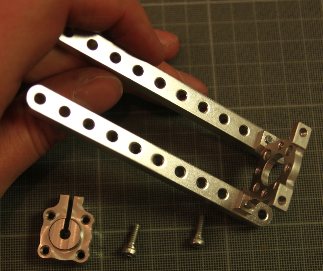

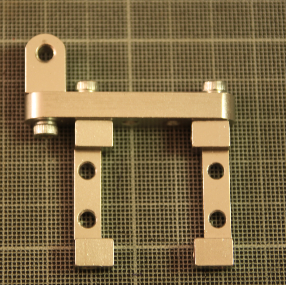

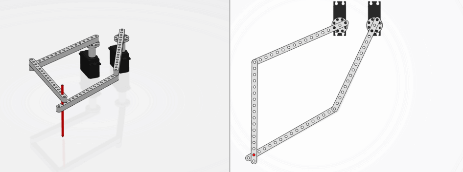

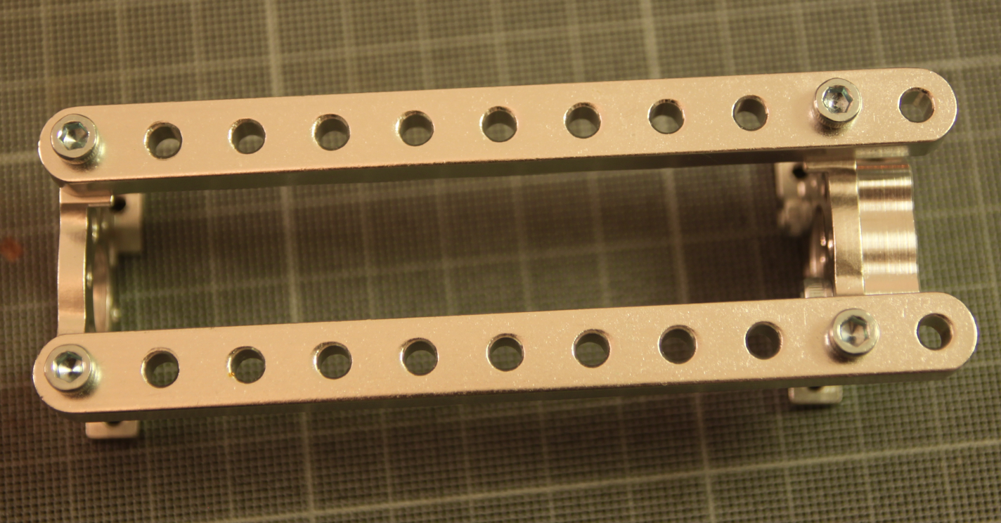

Basic mechanism
We will use two servomotors, each attached to an articulated arm. Each arm is made of two articulated segments, connected to a servomotor at one end and to the writing tool at the other end. The position of the writing end of the robot arms is completely determined by two angles controlled by the servomotors.

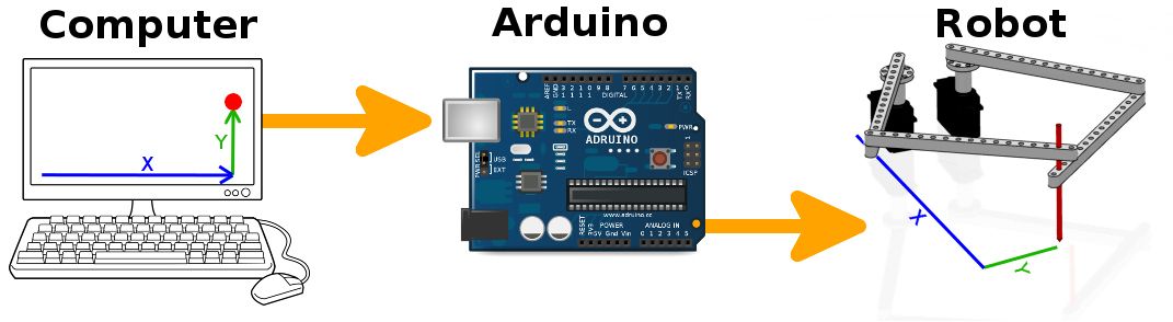

Basic architecture
Below is a quick preview of the setup. The computer will run a processing program which tracks the position of the mouse cursor, and send it over to the arduino board. This program is detailed in the Processing section of this instructable.
The computer is connected to the arduino board through the arduino's USB cable.
The position of the mouse cursor is converted to appropriate angles for the servomotors, this is detailed in the Mathematics section of this instructable.
The arduino is connected to servomotors through simple wires, Arduino controls the servomotors through another program. The wiring and arduino program is detailed in the Arduino section of this instructable.
The mechanical structure holding the servomotors, articulated arms and pen is detailed in the Mechanism section of this instructable.

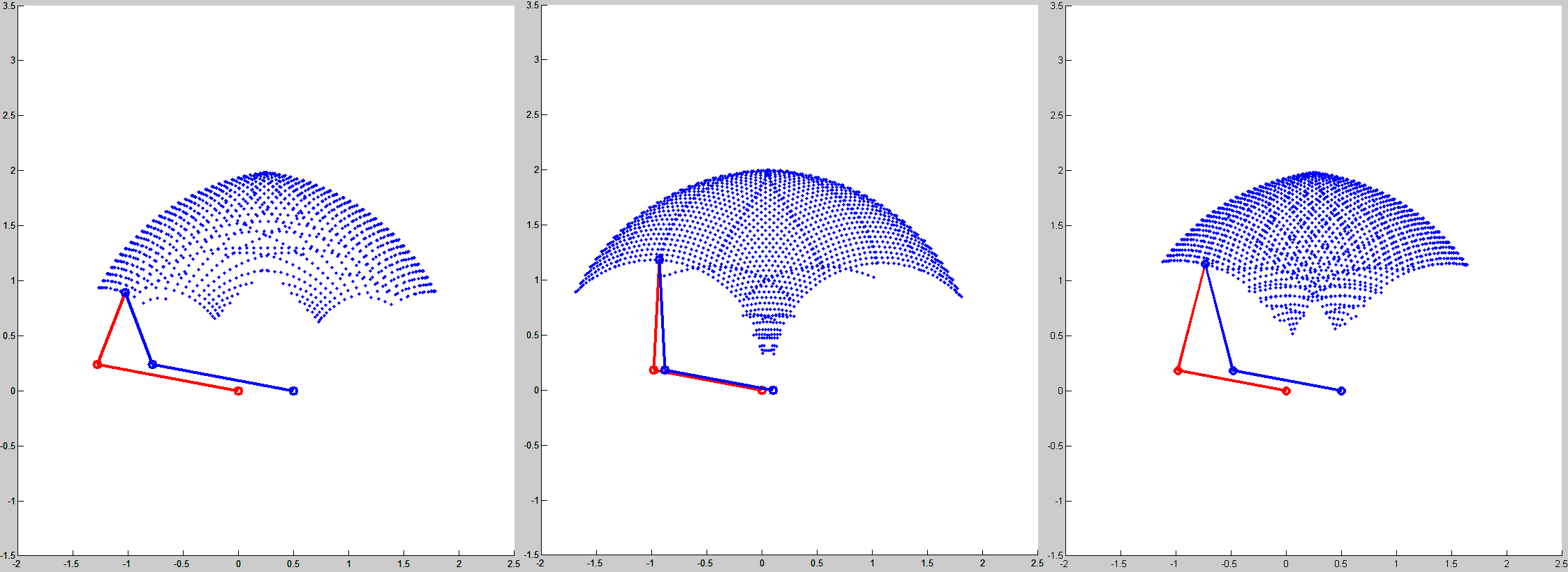

Adding the second servomotor
We can repeat the calculations done in the previous paragraph, except this time the point we want to reach P, is seen in the referential of the second servomotor, which is offset from the referential we used earlier.
Call d the distance between the axes of the two servomotors.
The coordinates of P in the referential of the second servomotor are : (x+d,y)
The configuration of the arms of the second servomotor is similar but mirrored, so that we find :
Call α2 the angle which must be fed to the second servomotor to reach position P :
α2 = θ2 - φ2
α2 = atan2(y,x+d) - acos( ((x+d)²+y²)1/2 / (2a) )
Feeding the angles α and α2 to the two servomotors will constrain P to be at the intersection of two circles = two points. We can restrict the domain of P in such a way that the pen will initially be placed at the topmost of these two points and never have the chance to switch to the other intersection point.
This way we can fully control the position of the pen by feeding two angles to the servomotors.
The images above show the shapes of the reachable domain on the writing plane for different values of arm length (a) and servomotor offset (d).

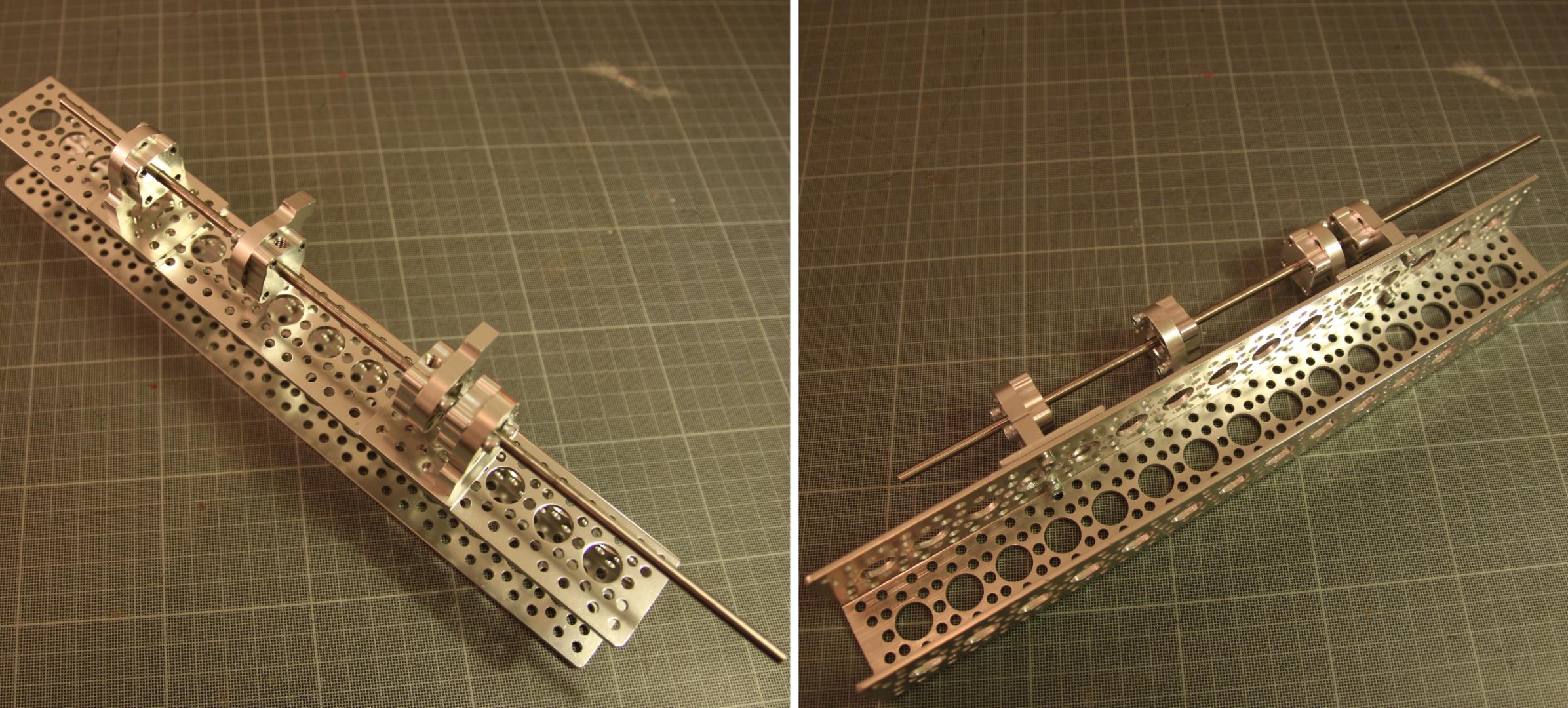

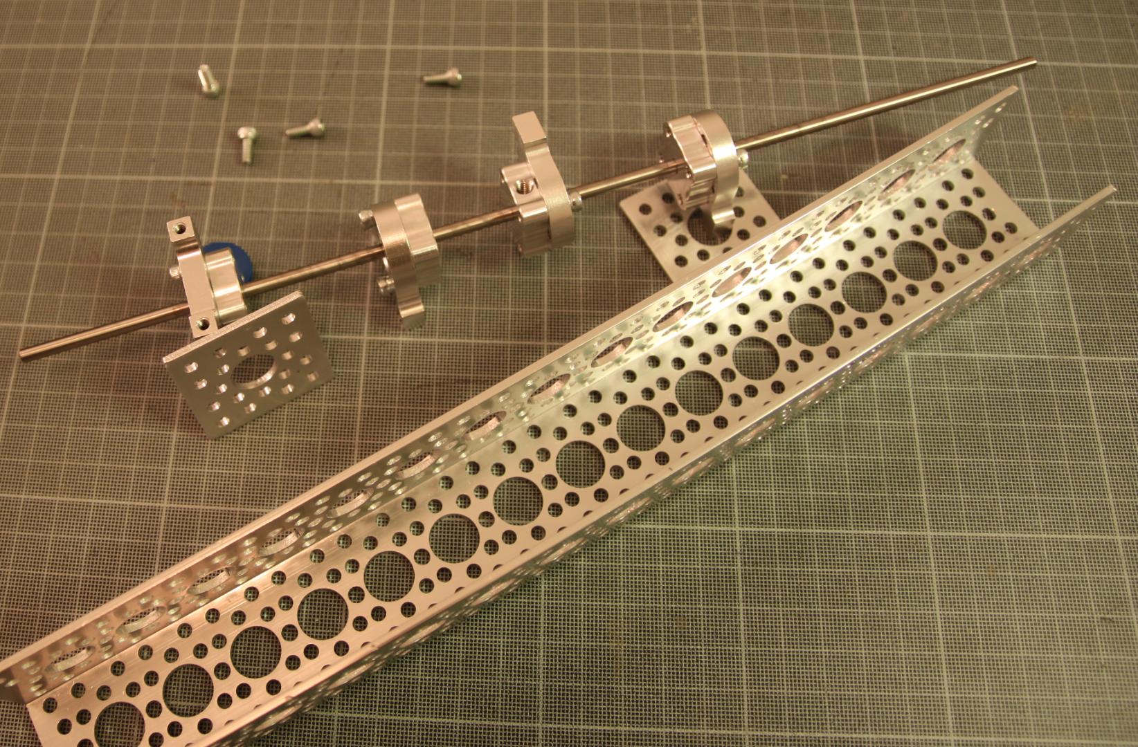

Step 5: Mechanism: the Main Channel
Here we are putting together elements on the main channel, the base of our robot.
For this step, we use :
- 1x 12" Aluminum channel
- 1x 4mm (300mm length) Precision shafting
- 4x 90° Hub mount C
- 2x Flat single channel bracket
- 4x 4mm Bore set screw hub

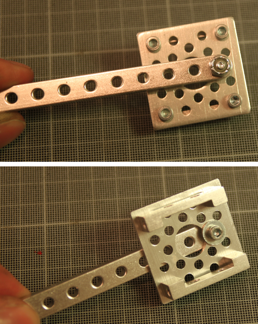

Attach the each hub mount to a a bore set screw hub :
Slide these elements on the long shaft :
Attach the hub mounts to the main channel, using the flat single channel brackets to offset them a little (this will give room for the rotation motion around the shafting to move the pen up and down) :
Your main channel now looks like the pictures below. The two central hub mounts and hubs are free to translate on the shaft :
Step 6: Mechanism: the Pen-up-servo Case (1/5)
Here we are assembling a case-like assembly around the pen-up (power HD) servo. This will later be used to attach the servo on the main channel.
- The power HD servo
1xFlat single channel bracket
The result should look like this :
Step 7: Mechanism: the Pen-up-servo Case (2/5)
- 1x 3.85 (11 holes) aluminum beams
- 1x Flat single channel bracket
- 2x 90° Dual side mount E
Step 8: Mechanism: the Pen-up-servo Case (3/5)
- The assembly from the previous step

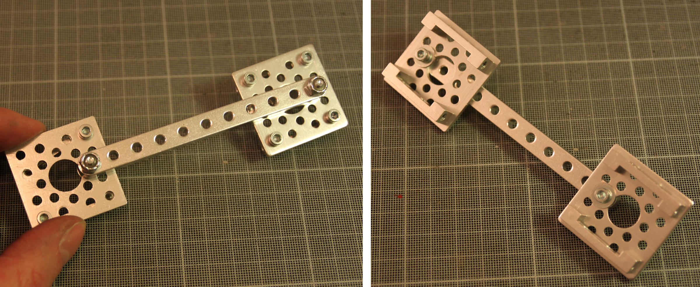

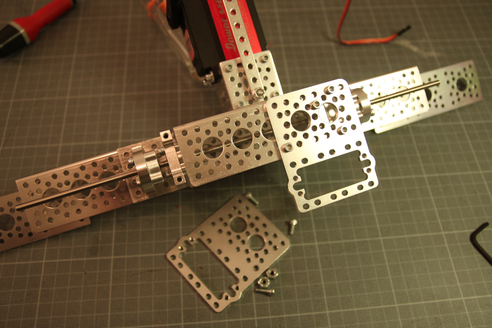

Step 12: Mechanism: Attach the Servo Plates to the Main Channel
Here we are adding two servo plates on the main channel, they will later hold the two angle servos.
- 2x Standard servo plate D
- 1x 3.75" Aluminum channel
Attach the servo plates to the small 3.75" channel like this :
And attach the servo plate to the hub mounts which you left free to rotate/translate on the long shaft on the main 12" channel :
Attach the second servo plate in the same manner. The servo plates + small 3.75" channel should now have a bit of room to rotate due to the fact that you raised the long shaft a little with the flat single channel brackets in the first building step.
Your robot now looks like this :

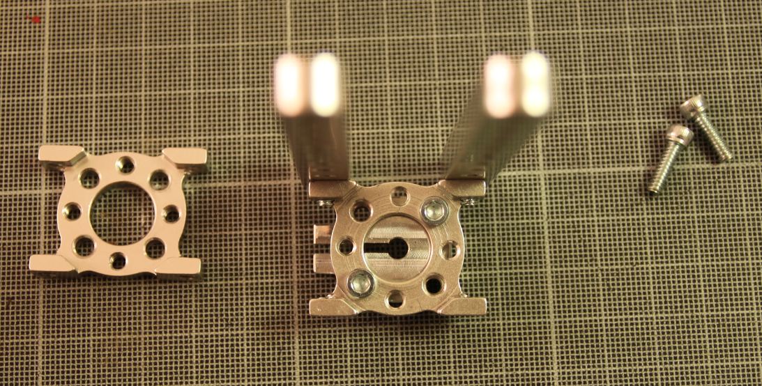

Step 13: Mechanism: Adding Hub Mounts
Here we are attaching two hub mounts on the servo plates we just added.
Standard Hitec ServoBlocks / Hub mounts
The servo plates now look like this :

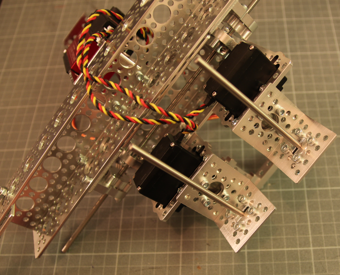

Step 14: Mechanism: Adding the Arm-servos
The servos fit snugly in the servo plates, as pictured above.
For this step, use :
- 2x Hitech HS-5645MG servos
Notice I chose to have the servo axes close together instead of split apart. This impacts the shape of the domain reachable by the pen. See the Mathematics section for more details.

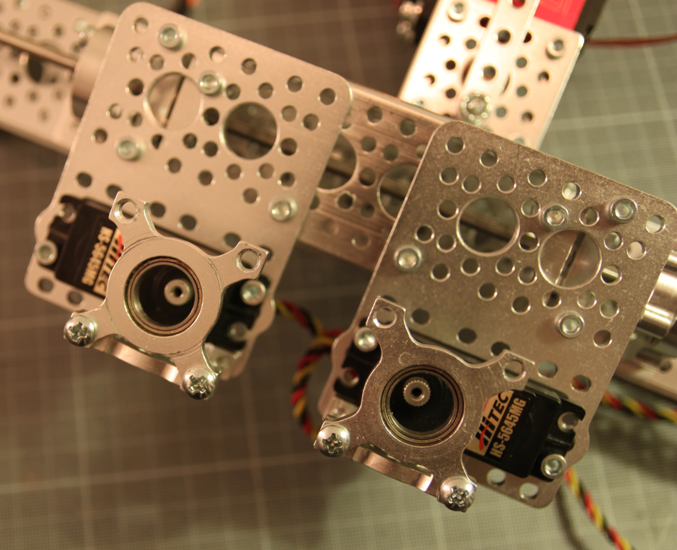

Step 15: Mechanism: Adding the Ball-bearing Plates
These plates will serve to hold the servo hubs tightly in place.
For this step we use :
Standard Hitec ServoBlocks / Ball bearing plates
Attach them to the hub mounts like this:
Step 16: Mechanism: Adding the Servo Hubs
The servo hubs are attached to the rotating servo spline. The robot arms will be attached to these hubs.
For this step use :
2x Standard Hitec ServoBlocks / Servo hubs
Fit the servo hubs through the ball bearing plates and attach them to the servo splines :
Here is a side view of the two servo hubs attached to their servos :

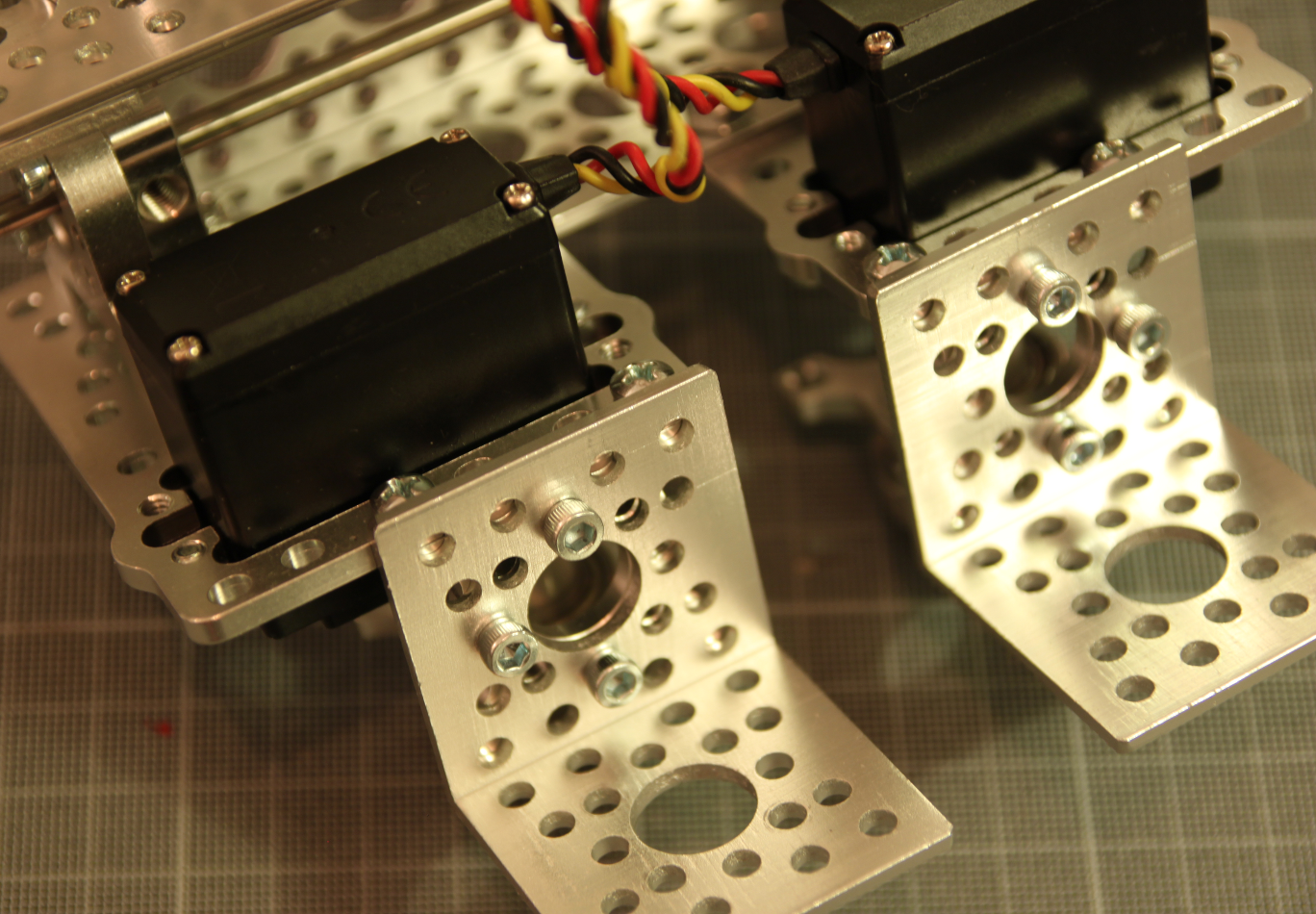

Step 17: Mechanism: Brackets in Front of the Servo Plates
Two 90° Single angle channel Bracket are attached to the front of the servo plates. These will later be used to attach two short shafts which will go from the servo mounts to the writing surface, to avoid the pen hitting too hard on the writing surface.
For this step use :
- 2x 90° Single angle channel Bracket
Screw them on the hub mounts like this :
Here is what it looks ilke after the two brackets are screwed on :

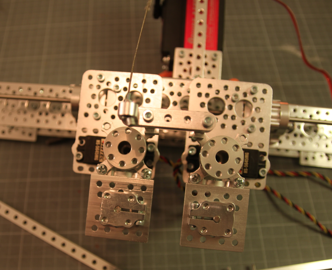

Step 18: Mechanism: Attachment for the Pen-up-servo Cable (1/3)
This little assembly will be attached to the moving part which makes the pen go up and down. The pen-up servo will pull on it to raise the pen.
For this step use :
- 1x 1.54" (5 holes) aluminum beam
- 2x 6x 90° Dual side mount E
- 1x Beam Attachment block
Step 19: Mechanism: Attachment for the Pen-up-servo Cable (2/3)
Attach the small assembly you just built to the ball-bearing plates as illustrated above.

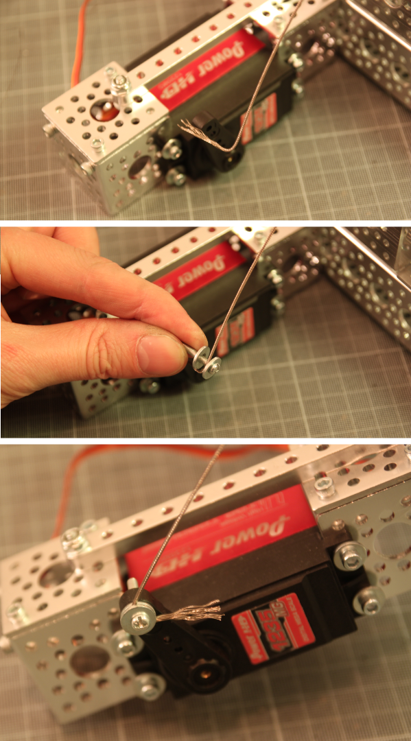

Step 20: Mechanism: Attachment for the Pen-up-servo Cable (3/3)
Run a cable through the hole of the Beam Attachment block and to the pen-up servo horn, as illustrated above and below :
Your robot with the pen-up mechanism complete now looks like this :

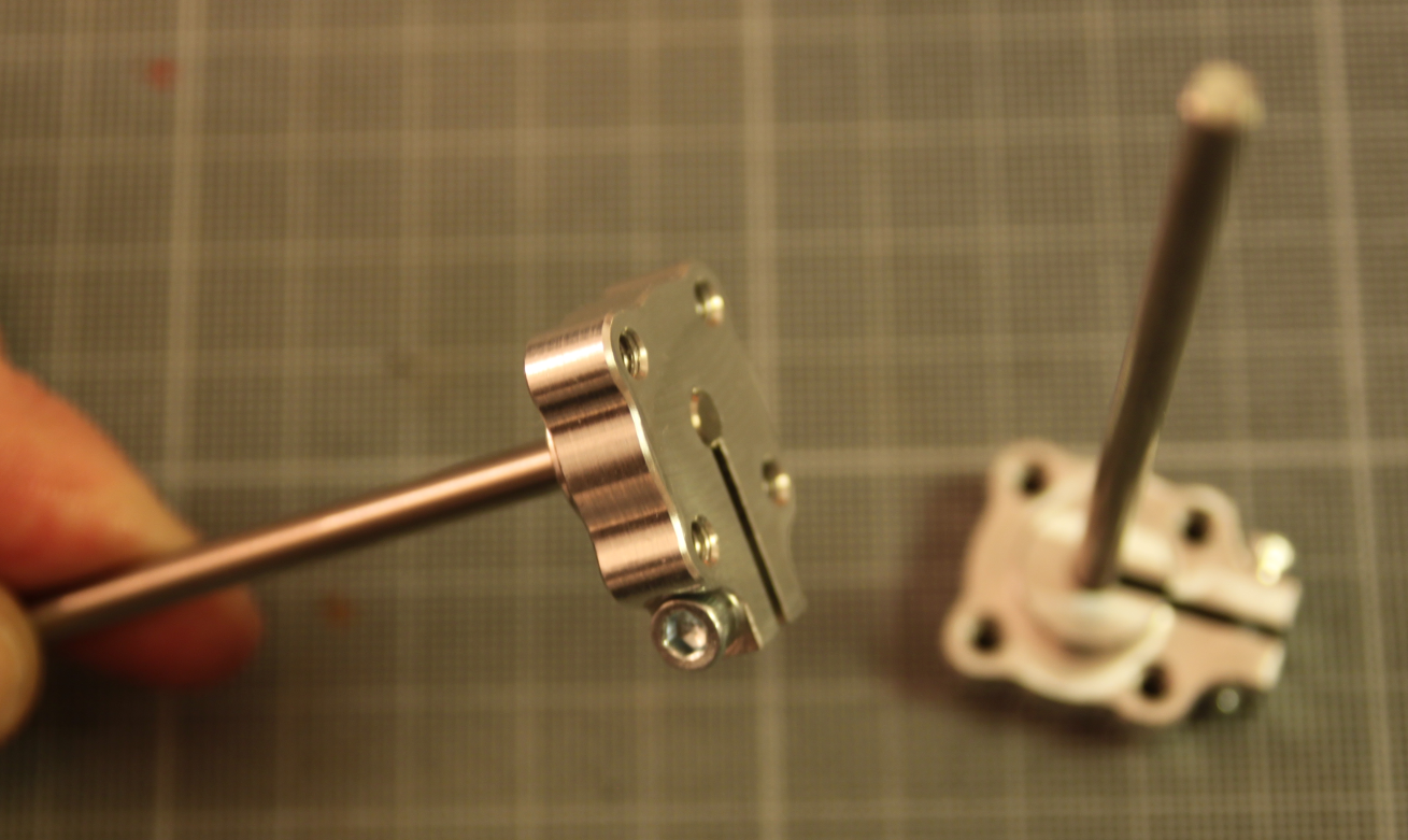

- 2x 4mm (100mm length) Precision shafting
- 2x 4mm Bore clamping hub
Attach the small 100mm shafts to clamping hubs in this manner (Don't tighten them just yet, you'll need to adjust the length so that they touch the writing surface at the same time as the pen when the pen is raised / lowered) :
Step 22: Mechanism: Resting Legs to Protect the Writing Tool (2/2)
Here we'll attach the short shafts and clamping hubs (aka "resting legs") to the 90° Single angle channel Bracket we added earlier, as pictured above.
Once both resting legs are mounted on the robot, it should look like this from the bottom :
And like this from the top :

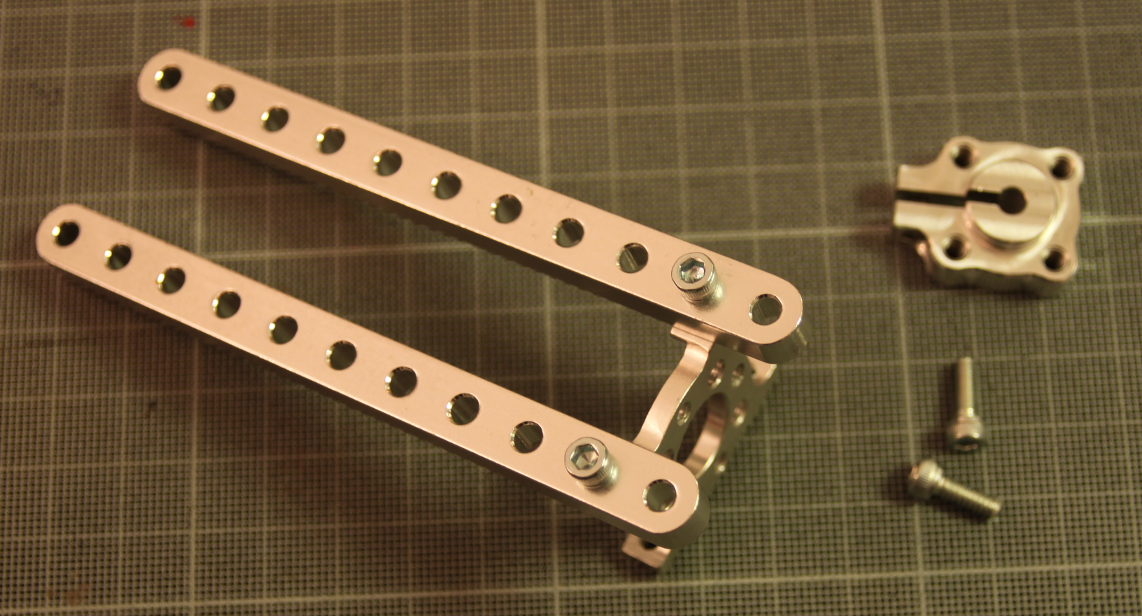

Step 23: Mechanism: Attaching the Arms !
- 2x 6.16 (17 holes) aluminum beams
Attach these beams to the servo hubs. Note that the 2nd hole of the beam is in line with the servo's rotation axis. The efficient length of the arm segment is therefore 16 holes (5.6").
One arm is attached :
And now both arms :
Step 24: Mechanism: Attaching the Second Arms Segments
Here we are attaching a second arm segment or "forearm" to the arm.
We are using the second hole of the forearm in order for all effective segments to be of the same length (16 holes).
For this we use :
- 1x 6.16" (17 holes) aluminum beams
We are not attaching both forearms just yet, as we will be building the pen attachment system to the other forearm in the next steps.
Step 25: Mechanism: Pen Holding System
For this step we will use :
- 2x 3.85" (11 holes) aluminum beams
- 2x Standard Hitec ServoBlocks / Hub mounts
- 1x 4mm Bore clamping hub
Attach a hub mount to the 3.85" aluminum beams like this :
Then attach the clamping hub to the hub mount like this :
And finally, attach the second hub to the opposite side of 3.85" aluminum beams like this :
Step 26: Mechanism: Fitting the Biro in the Pen Holding System
A standard biro will fit perfectly in our pen holding system !
Step 27: Mechanism: Attaching the Pen Holding System to the Arm
Here we are attaching the pen holding system to our remaining arm segment, as illustrated above.

Step 28: Mechanism: Joining the Two Arms
The two forearm extremities are joined on the axis exactly above the pen point.
Notice the arm segments' over/under configuration.
Step 29: Mechanism: Finished !
It is now time to bask in the beauty of our magnificent robot and perform a global checkup.
