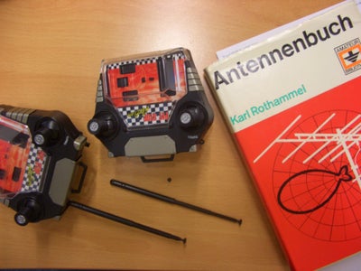

Looking around the Internet and the "Rothammel" I found that the "sleeve antenna" is ideal. It easy to construct and the elements can be build using expendable antennas from r/c remote controls.

Get some extendable antennas from r/c remote controls. I had some lying around from small r/c cars I bought on eBay ( https://www.instructables.com/id/Using-RC-car-parts-as-remote-control/ ). Using a thin coax cable (RG-174), the cable could be feed through the small pipes of the antenna.
Two antennas will be used for the sleeve antenna, being a vertical polarized dipole. The antenna will be small because it is build for a frequency range 470Mhz to 740Mhz. This makes the mechanical construction easy. Just use some heat shrinkable tubing to fix them.

Step 3: Preparing the R/c Antennas
Remove the antennas from the r/c remote controllers.
One antenna need to be shortened, because we like to feed the coax cable through it. In my case I needed to cut the two thinnest elements. To find out how much you need to cut, just look for the smallest elements that is big enough to contain the coax cable. Now the mounting base need to be cut off completely so that the coax cable can be feed through the whole antenna.
The other r/c antenna should be left mostly untouched. Only parts of the mounting base should be cut of. This makes it easier to solder the coax cable to it.
