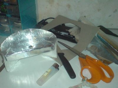

Step 1: Cutout Required Parts
The first step is to cutout the main parts for the reflector. You may download a stencil from this link:
http://www.imod.co.za/wifi.pdf
Once you have downloaded that stencil, simply cut out the two shapes as shown in the image below.
Step 2: Cover in Tinfoil
Once we have cutout our shapes in step 1, we need to cover the shapes in tinfoil and fold them to the correct positions. The guide in step 1 will show you how to fold them. The image will explain better..
Step 3: Cutout a Small Hole for Antenna
At this point, we will have two shapes, cutout, covered in tinfoil and folded to the appropriate position. We will need to cut a small hole out for the routers antenna to peak through. See image:
Step 4: Put It All Together
Simply place your booster onto your current antenna, and that's it.
Enjoy a lovely increase in your signal strength. Remember to aim your booster in a good direction.

    Dont put foil on the center brace. it will work much better.. :)

    Nice! Took 5 minutes out of my day to make this, and saw my signal went from 60-65% to 95-99%. Thank you for sharing this one, works like a charm.

    Unfortunately the templates aren't quite the correct size. When I printed out the templates, I cut them out as directed but then discovered that the semi-circular piece did not slot into the rectangular piece because the slots were not far apart. After improvising a little I did get mine to work and I can say that it increased the signal strength by a whole bar. Thank you!

    Are you sure you should cover the inner part (where the antenna peaks through) in tinfoil too? I think this will have bad effect, because a part of the antenna will be 'caged in'. I've made one myself some time ago and only covered the actual reflector (back plate) with tinfoil, worked fine for me.

    i agree too, covering the inner part would bounce most of the signal away, making it pointless

    Gorilla - I'm actually not sure, I've only used it for a Wireless Router, but I don't see why it would not increase any signal. samv - I tested both ways and I got a better signal by covering the whole area visible by the top of the antenna..
