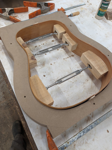

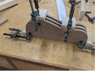

Step 2: Making Jigs
There are four specialty jigs you need to complete this project. An internal jig to bend the sides, external jig to hold the sides in place while you add many components, a go-bar deck, and at least one radius dish.
The internal and external jigs should be made made of MDF. The first step of this project was to focus on the sides. In order to do this, I needed to create the molds to build the guitar around. I utilized ¾” MDF boards that were eventually laminated to make these molds. For the negatives, I drew the plans for the molds & cut a single template of half of the full mold on the bandsaw. Once it was cut & sanded on a disk sander, I rough cut the other five identical parts on the bandsaw. Using the original template as a guide, I flush cut each part on the router, making all six pieces completely identical. These six pieces were glued in two groups of three in order to create both halves of the mold. To prepare for the glue up, I drilled three holes in each piece for a ¼” dowel to ensure that the pieces did not shift during the glue-up process. Using Titebond type 3 wood glue to ensure a durable bond, the six pieces were laminated in two groups to make each of the two halves of the final mold. The mold was made in two halves, rather than one full piece, in order to allow for easy removal of the mold from the sides in later processes. I later made three spreaders, using 8/4” basswood, carved to resemble the positives of the upper bout, waist, & lower bout of the guitar on both sides, & connected them using turnbuckles that allowed for adjustment in clamping pressure of each spreader.
The positives of these cut mold parts were then used to create a single bending jig. They were spaced out using shallower versions of each to allow for airflow for the heat bending process. ¾” Holes were drilled on the drill press, with 3” of spacing between each around the perimeter of both sides of the mold for spaces to utilize F clamps for the later bending process. To compliment this, using 8/4” basswood, I carved small negatives of the 4 points with the most extreme curve to use as clamping blocks.
Your go bar deck could be like mine which is just a cart I flipped and put on the table. My bars are made out of poplar. Ensure the bars are all uniform thickness (you will thank yourself later) and the correct uniform length. If they push to hard you will dent your spruce.
I made my radius dish on a CNC which is the only point in this project which I used one. Mine has a 25' radius which is pretty standard and is made of MDF. Many guitars use a different radius on the from comparted to the back. You can also buy a radius dish. Using spray glue I covered it in low grit sandpaper.

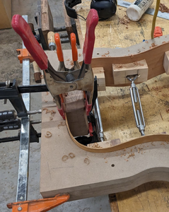

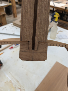

The top and bottom of the sides have two blocks glues connecting them. Before you glue the sides together trim off the excess length with a Japanese rip saw. The sides don't need to be perfect in length but they should be close. Follow the plans and make the blocks out of hardwood. If you need to glue multiple pieces of wood together you can. If you plan to add a pickup jack or something you might want to make the heel block out of plywood to help prevent cracking. I made both of my blocks out of mahogany. Make both blocks a tiny bit oversized in length. Glue them on centered at the top and bottom of the guitar accordingly. When you radius your sides you will sand these to be perfect length. After you have your sides connected together use a finger plane to make your sides the correct width. You can add chalk to the sides and see where material is coming off when sanding on the radius dish. To sand on the radius dish twist your sides on it while they are in the external jig. Make sure you don't go under the correct width. The sides don't need to be perfect and it will be much easier to sand once the kerfing is added but the correct width needs to be within the correct ballpark before it is added.

Kerfing gives your guitar the required amount of surface area. Buy your kerfing on Ebay or from Stewmac. Kerfing simply is a piece of wood with a bunch of tiny grooves in it making it flexible. Glue your kerfing on a bit proud of the sides and use cloths pins to clamp them. You might need to use more than one piece of kerfing. I used mahogany kerfing. The kerfing goes on all 4 edges of the sides.
Side braces add a bit of strength to the guitar along with preventing any crack that might form from going all the way around the guitar. My side braces are made of mahogany and are 5mm wide. I shaped these to a point on the disk sander to make them more stylish. Glue these in according to the plans. I measured from the center point of the guitar to the outside edge using the length I measured from the plans. This gave me the location of where to glue these in.

Next you should cut the mortise for your neck. Follow the drawings for the size of the mortise. I used a band saw to cut out the majority of the material and a chisel to finish it off. I then drilled two holes in the mortise. We will use these to bolt on the neck later. The bolts allow the neck to be test fit with ease along with applying clamping pressure when the neck is attached.

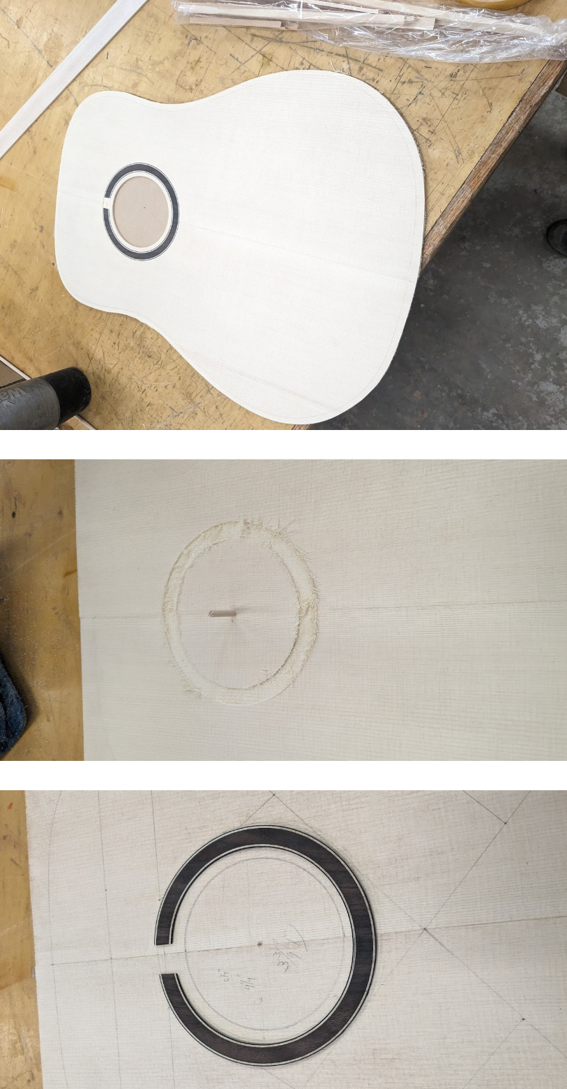

Step 10: Rosette
For this step you can either use a trim router or a Dremel. You will also use this tool to do your binding and purfling. I have only ever done this with a trim router so that is what I will be talking about. To start you can make the rosette yourself or simply buy it. Whatever you pick you also need to buy a bit that is the same diameter as the width of the rosette. I made a simple circle jig for my trim router but you could buy it. My jig simply was a piece of wood with a hole for the bit and mounting holes to the trim router. I then drilled a hole in the jig the radius of the rosette away from the center of the collet. Using a dowl with a tight fit and simply spun the trim router on that point. Set the height carefully to ensure you don't go through your top. The rosette just needs to be barely set into the top. Do many tests on scraps to ensure the rosette fits perfectly. When you cut the channel in your actual top since it is thin add a scrap of wood behind it with the pivot hole for stability. Add a small amount of glue to the rosette and place a weight on top. Once dry sand until flat.

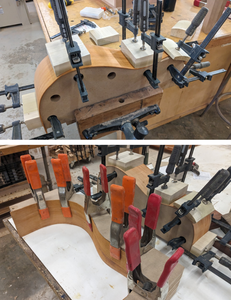

For this step you will need to use the go-bar deck. Place your radius dish at the bottom of your go-bar deck and place the piece you plan to add braces to on it. Add glue to the bottom of the brace after marking where you want to line it up. Using the go bar deck add multiple bars to the brace. There should be no gap between the brace and the now bent piece of wood. Continue this process until all the pieces are glued on. Do no overuse the glue. Add the back strip last if it is multiple pieces cutting the length of each section based on the distance between braces on the back. Add the back strip first if it is one piece. You will need to cut into it to add the braces.

It is important during this step to get constant pressure on the entire outside of the guitar. I used a system of clamps on the outside of my external jig used to hold the sides to clamp my top and bottom on. The clamps are simply a piece of all-thread which I cut up and added small pieces of wood with threaded inserts to the end. You probably don't need as many as I used but more can't hurt. If you don't want to make this setup you could use your go bar deck with either shorter bars or a taller stand.

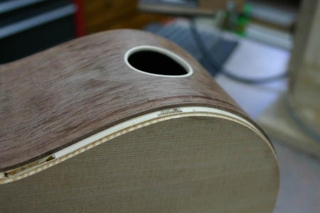

Step 15: Cutting Binding and Purfling Channels

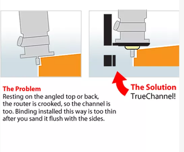

Start by bending your binding. Follow the same procedure you used to bend your sides. Really focus on trying to keep the binding straight during the bending process. If you have a really oily wood with a really light wood it may stain it from the steam. This should go away once sanded.

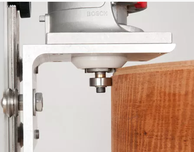

I completed this step using a trim router. If you plan to use a Dremel I would only recommend using the Stewmac jig and bit. For the trim router you need to buy the Stewmac bit. It is expensive but is totally worth it. I spent 4 hours switching bearing and grinding the slightest bit off the end of bits before I finally gave up and ordered the Stewmac one. It includes bearing that are very close in size allowing you to make the fit perfect with your binding.

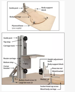

There are many ways to create the stand to do the binding. The trim router needs to be held at a perfect 90 degrees at all time and the top of the guitar is not flat. This is from the radius of the sides and the side profile of the guitar is not parallel. Using a large piece of aluminum angle I drilled holes to fit my trim router. For the center hole I mounted a Delrin bushing to ride on the top of the guitar. I placed this assembly on a linear bushing using the 8020 system. The guitar was then mounted to a stand allowing me to adjust the height of the top of the guitar from 4 points. Before I made my binding I adjusted the feet so the top of the guitar is flat. Here is the link to the Stewmac stand.
On a test piece using the jig create a groove. Using your binding test the fit. The edge of the binding should be a tiny bit proud on all sides. Adjust until it is perfect. Next to the same with the purfling. It should sit proud toward the top of the guitar but fit perfectly in the binding channel. Once you have ensured both are perfect on a test piece do it on the actual guitar. If you simply go around the guitar you will get an extreme amount of tear out. Look at the picture above. Any place that does not have an arrow move the router in a opposite direction f the arrows very slowly. This will mitigate tear out.
Step 16: Glue in the Binding and Purfling
To complete this step you will need Stewmac's binding tape. Normal tape will tear out the wood fibers on the top and there is no other real way to clamp this. Starting at the bottom add glue to the channel and begin taping on the binding the purfling. You can glue them in together or separately. Don't add glue on the entire channel at once. The glue will begin to set at the end before you get to it. To use the binding tape place it on the side and pull it tight as you wrap it around the top. This will create enough clamping force to hold the binding on. Go around the guitar until you complete the entire thing. Remember at the top it will be covered by the neck. Focus on making the joint perfect at the bottom near the end wedge. Once you do this you are done with the guitar body.

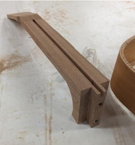

Step 17: Neck Blank and Tenon

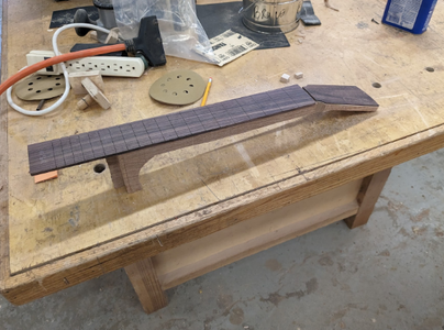

We are now ready to move onto the neck! The piece of wood you use for the neck needs to be quarter sawn and straight grained. This will give it a significant amount more strength compared to a normal piece of wood. Following the plans cut four pieces of wood to make the part of the neck where it connects to the guitar. Don't forget to leave enough length for the tenon. Glue these pieces to the guitar attempting to keep the grain looking natural. At the top of the guitar we are going to cut a 15 degree scarf joint. First, mark where the joint needs to be cut based on the plans. After than go to the band saw and cut on your mark as straight as you can. I used a resaw band saw to perform this cut as the wide blade helped me to make it straight. After that flip the piece you cut off over the glue it back on top. This can be a difficult glue up because the neck tends to want to move. Follow the picture above to prevent this. After the glue has dried used a combination of the disk sander and a hand plain to make this section flat.
The next step it to create the tenon on your neck blank. The end of your neck needs to be the angle of your soundboard to the sides. Once you know this angle use the miter saw to cut this angle on to the end of your neck. I then marked the size of my mortise in the center of the neck. I used the router to cut tenon. Holding the neck upright I set the fence so the router would take away the material. I did this over the course of three passes. Slowly running the neck over he router removes the material without the neck jumping. Be careful to keep the bottom of the neck planted on the table. This will create the angle on the neck that contacts with the body of the guitar. Once you complete this process you are ready to add the threaded inserts into the neck. Push the neck onto the guitar and mark the holes. Drill a hole for the threaded insert in the tenon. Make sure it is the correct size or when the threaded insert is added it will crack the wood. Add a small amount of medium viscosity super glue when adding the threaded insert to prevent it from coming out.
Step 18: Truss Rod and Fretboard Mounting
First we will create the truss rod mounting slot. This is completed on the router. Measure the width of the truss rod and select a bit of that diameter. Hold the truss rod up to the side of your neck. Mark on the side of the neck where you need to stop making the channel. If you make the channel to long the truss rod will not work. Next mark the center of the neck. You should use a router table with a fence to complete this operation. Place the neck face down on the table lining up the center of the neck with the center of the bit. Push the fence up to the neck and lock it in position. After this simply set the bit to the correct height and make the cut. Glue in the truss rod using super glue or epoxy.
The fretboard will act as a guide as you carve the neck so it should be glued on now. I started by spray gluing on the fretboard template from my plants to get eh shape correct. I then cut the fretboard about an 1/8 of an inch oversized side to side and on the mark at the top. Mark the center of the fretboard on the ends and the center of the neck. Make sure to leave space for the nut at the top. Glue on the fretboard using a caul. Once this joint is dry cut the excess off the neck not forgetting to leave space for the headstock.

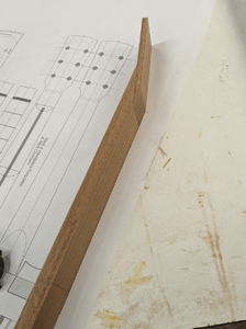

Step 19: Headstock
To shape your headstock it will be easiest to make a template the flush trim it using the router. Cut out the headstock shape spray glue it to a piece of MDF. Align with the fretboard and use double sided tape to attach the template. Don't forget to leave space for the nut. Using the band saw cut close to the template. Since the neck is curved use a flush trim bit with the bearing at the bottom to finish cutting out the template.
The headstock of the guitar is a spot for the luthier to add personal touch to the guitar. My headstock is a piece of wenge with thin pieces of cocobolo going through it. I started by using the wide belt sander to create a thin sheet of cocobolo and cut into 1/2 inch wide strips. It only needs to be thin enough to be flexible one cut into strips. I then ran a piece of wenge large than my headstock through the planer until it was about 1/4 of an inch thick. Using the band saw I made one curved cut. The trick to getting this to work is to do a smooth cut with a large radius. I then used super glue to reattach the two pieces with a piece of bent cocobolo in the middle. I repeated this process until I thought the headstock looked good. After cutting off the excess on the band saw I ran the headplate through the wide belt sander. I then glued the headplate with a maple veneer underneath on the headstock. Using a flush cut bit and the already cut out neck as my profile I fit my headstock.

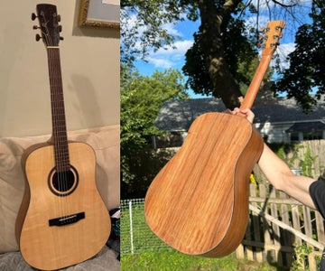

Step 24: Final Steps
Fit nut and saddle to their slots. I bought them already intonated so I simply needed to make them fit. I sanded them to gain a perfect fit. Once you attach the strings you will want to check that the action (heigh between strings and fretboard) is about the height of a nickel. Sand the height of the saddle accordingly.
My neck is glued on using Titebond 1 because it is theoretically removable. I did a few practice runs before gluing on my neck. Once I ensured the fit was good I glued the neck on adding glue to the mortise, tenon, and area under the fretboard. My primary means of clamping the neck were the bolts going through the mortise and tenon. I also added a clamp through the sound hole on the front of the fretboard with a caul to help hold it down. Once this is dry add some strings and start playing!
