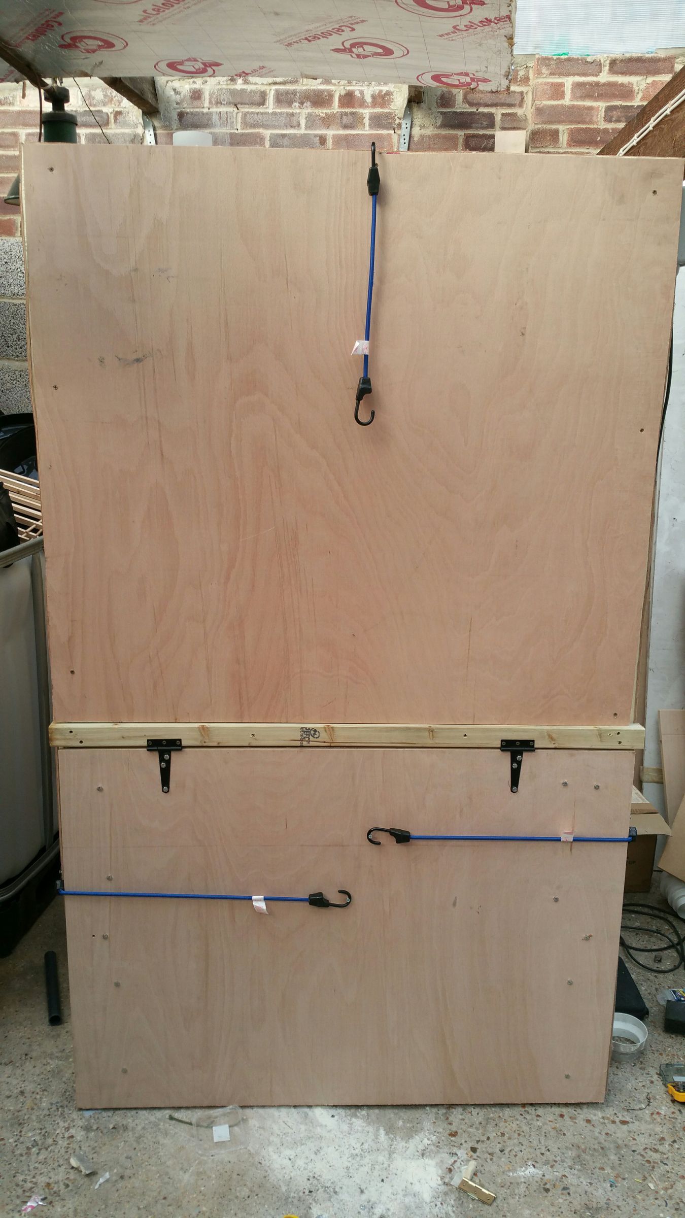

Step 1: Building Your Grow Bed.
First, measure the area where you intended the grow bed to live. Then decide if you are going to build it in place or in a separate work area.
You will need a table saw to cut the wood to shape. I cut my own wood but you can also get wood cut at places like B&Q.
Most plywood is sold in sheets 2 4m x1.2m I try not to have a join in the base of the box. Joins remove strength and that risks leaks. A 1.2m wide grow bed is also the widest possible bed to work if you can only access it from one side.
Choosing the depth of your grow bed is very important.. 40cm is best as it gives your plants space to grow and allows a layer at the bottom that breaks down fish waste very efficiently. Giving you space for an aerobic zone and an anaerobic zone. Over time this breaks down fish waste better and releases all of the nutrients in the solid fish waste.
Remember that your media beds have clay balls so a 400L capacity media bed only needs +-160L to flood and drain.

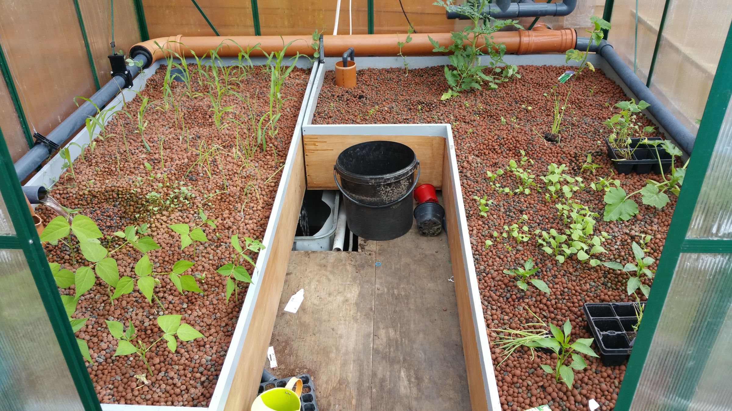

Now that they are in place, you need to decide if it will be a Media bed or a Raft bed.
Fortunately, I did one of each in this system.

So, flow rates are a bigger issue in flood and drain systems. Ideally you should flood your grow bed 2-3times an hour. This doesn't take much flow so there is no need for super fast top up.
Finding the right flow speed for your bell syphon is very important. If your water flows too slow then you can have an issue where your syphon never starts.
If the water is too fast then your syphon may never break leaving your bed constantly empty.
If it's even faster then you may end up with overflowing beds. That's messy and ruins your plants.
Take the time to find the setting that works.
It's also easy, when planting in a media bed to forget how big plants really get. I made that mistake with my tomatoes this year. I guess we are always learning.
Fortunately, you don't need to grow seedlings separately. Just sprinkle your seeds on top of your media bed and most types will grow without an issue.
I grow my seedlings for my fast bed in a media bed. Mostly lettuce. I grow them for about 2 weeks then transplant them into the time net pots with a few clay balls for the roots to hold on to. They grow strong and fast.
