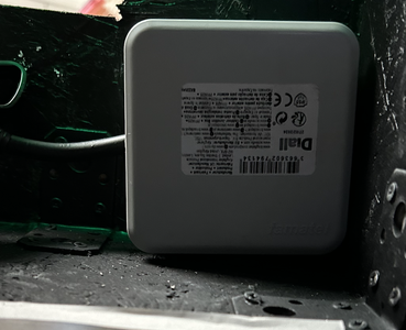

Step 3: Electronics and Audio Setup
The Pandora’s Box gaming console was the heart of the system, offering thousands of retro games.
I mounted the screen inside the cabinet and connected it to the console. For sound, I used an amplifier and two speakers, which I securely placed in the top section for maximum audio impact. Wiring everything together required careful organization to keep it neat and functional.
A power strip inside the cabinet ensured all components had a single, easy-to-access power source.
