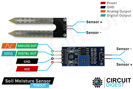

Step 1: Understanding the Soil Moisture Sensor
The soil moisture sensor, also known as the soil humidity sensor, features four pins: VCC, GND, Aout, and Dout. These pins facilitate the retrieval of soil moisture data from the sensor:
  • VCC: Power supply pin, connectable to either 3.3V or 5V supply. Note that the analog output varies depending on the supplied voltage.
  • GND: Ground pin, connected to the Arduino's ground pin.
  • Dout: Digital output pin; low output indicates appropriate soil moisture, while high indicates low soil moisture.
  • Aout: Analog output pin, providing an analog signal between VCC and ground.
Step 2: How Does a Soil Moisture Sensor Work?
The operation of the soil moisture sensor is straightforward. The fork-shaped conductive probe is inserted into the soil, featuring two exposed conductive plates that act as a variable resistor. The resistance of the probe is inversely proportional to the soil moisture: more water in the soil leads to better conductivity and lower resistance, while less water results in higher resistance. The sensor produces an output voltage corresponding to the resistance, allowing us to determine the moisture level.

Step 4: Circuit Diagram
The soil moisture sensor module schematic and Arduino code are provided for reference. The schematic illustrates a simple circuit using an LM393 op-amp to convert the analog signal from the sensor probe into a digital signal. The Arduino code reads the analog data from the sensor and adjusts the LED brightness accordingly.
