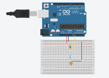

The resistance can be measured using a voltage divider as shown in the picture above. It's a really simple circuit with R1 beeing a fixed resistor and R2 beeing our variable resistor. Since the current through all resistors in a row is the same, the voltage drop at every resistor is dependent on it's resistance - or it's proportion of the total resistance of the circuit. So as the water level increases, the voltage measured at 'Analog In' increases until the whole sensor is covered in water.

Now build the circuit on a breadboard (note: the editor for the picture had no water level sensor, so I inserted a photodiode instead - just connect the jumpercables from the grid) and upload the attached code to the arduino.
