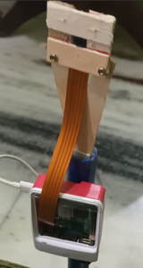

Set up the Raspberry Pi: Insert the MicroSD card with Raspberry Pi OS, connect the power supply, and connect the Raspberry Pi Camera Module to the camera port.
Set up the Ultrasonic Sensor: Mount the ultrasonic sensor before the camera to detect when a product passes through. The sensor will trigger the image capture process. Preferably, connect the sensor to an Arduino if you're using it to control the conveyor belt, and then establish communication (e.g., I2C, serial, or GPIO) between the Arduino and the Raspberry Pi. This will allow the Raspberry Pi to know when the sensor detects a product and trigger the camera to capture the image.
Camera Positioning: Mount the camera in a fixed position that captures clear images of the product passing through (adjust the angle for optimal viewing).
Optional Conveyor Belt: If using a conveyor belt, mount it on a stable surface and connect the stepper motor to the Raspberry Pi to control movement. Alternatively, you can use a microcontroller (like an Arduino) or connect the Raspberry Pi to the existing controller of the conveyor system to manage the motor and movement. This can help offload the motor control task from the Raspberry Pi, freeing it up for other processing duties.
Background Setup: Use a white background or a white sheet behind the product for consistent lighting and better image contrast. This helps the camera distinguish the product from the background, improving the accuracy of defect detection.
