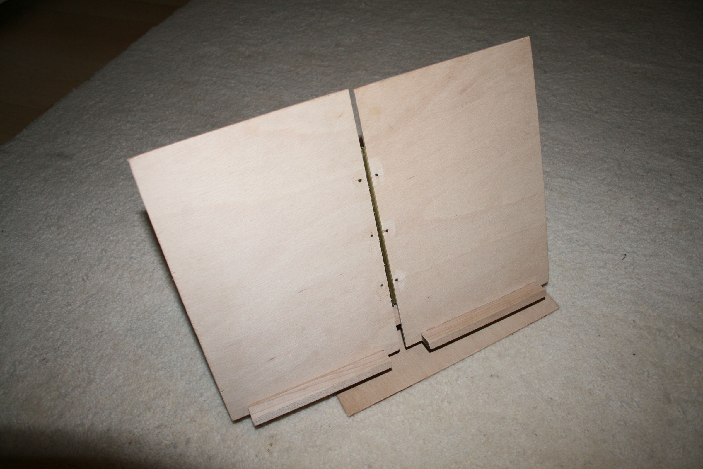

Step 4: Pieceholder at Work
Next you have to build a piece holder, which holds the wood in shape while you are working on it.
It's very easy to build: First, you outline the shape onto a think sheet of wood with a pencil or something alike. Then you drill holes on the outside of the form you've just drawn. The holes have to be big enough to stick wood-sticks through it. Now put the wood sticks into it, but none of the must be higher than the bended wood itself.
The wood experiences pressure from the outside. Give it some pressure from the inside to by squeezing another wood stick into it.
Now you can begin working on it
