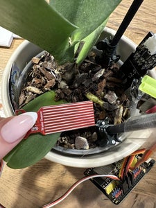

  • Soil moisture sensor

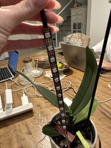

  • LED strip (individually addressable)

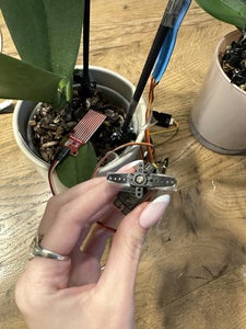

  • Servo motor

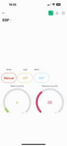

Step 1: Install Blynk App
  • Download and install the Blynk app on your smartphone.
  • Create a Blynk account if you don’t have one.
Step 2: Create a New Blynk Project
  • Open the Blynk app and create a new project.
  • Select ESP32 as the device and WiFi as the connection type.
  • Copy the Auth Token provided by Blynk and paste it into your Arduino code.
Step 3: Add Widgets to the Dashboard and Configure Them
  • Add a Gauge widget for soil moisture and link it to Virtual Pin V1.
  • Add a Gauge widget for water level and link it to Virtual Pin V4.
  • Add a Button widget for manual watering and link it to Virtual Pin V3.
  • Add a Button widget for manual LED control and link it to Virtual Pin V5.
  • Add a Button widget for mode selection (manual/automatic) and link it to Virtual Pin V2.

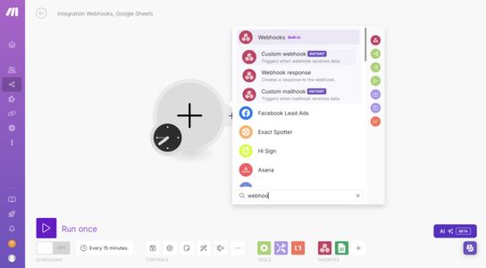

Step 6: Add a Webhook Module
  • Search for "Webhook" and select "Custom Webhook".
  • Click "Add" to create a new Webhook.
  • Name your webhook (e.g., "PlantMonitorDataWebhook") and copy the provided Webhook URL.
Step 7: Configure the Webhook Module
  • Set the Webhook to capture all necessary fields.

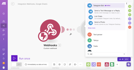

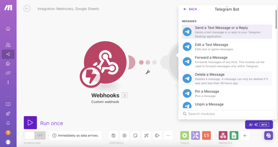

Step 8: Add a Telegram Bot Module
  • Search for "Telegram" and select the appropriate action (e.g., "Send a message").
  • Connect your Telegram account and configure the message content based on the incoming data.

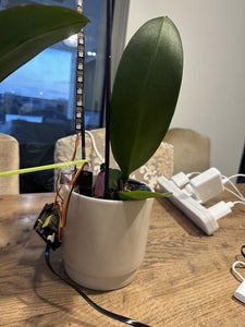

Step 12: Physically Building the System
Gather Components:
  • ESP32 microcontroller
  • Water level sensor
  • Servo motor
  • Breadboard and jumper wires
  • Power supply
Step 13: Connect the Components
  • Soil Moisture Sensor:
  • Connect the VCC pin to the 3.3V pin on the ESP32.
  • Connect the GND pin to the GND pin on the ESP32.
  • Connect the signal pin to an analog pin (e.g., GPIO 35) on the ESP32.
  • Water Level Sensor:
  • Connect the signal pin to an analog pin (e.g., GPIO 34) on the ESP32.
  • LED Strip:
  • Connect the power and ground lines to the appropriate power supply (e.g., 5V and GND).
  • Connect the data line to a digital pin (e.g., GPIO 26) on the ESP32.
  • Servo Motor:
  • Connect the VCC pin to the 3V pin on the ESP32 (or an external 5V power source).
  • Connect the control signal pin to a PWM-capable pin (e.g., GPIO 33) on the ESP32.
Step 14: Power Up the System
  • Connect the ESP32 to a power source.
  • Ensure all sensors and components are properly powered.
