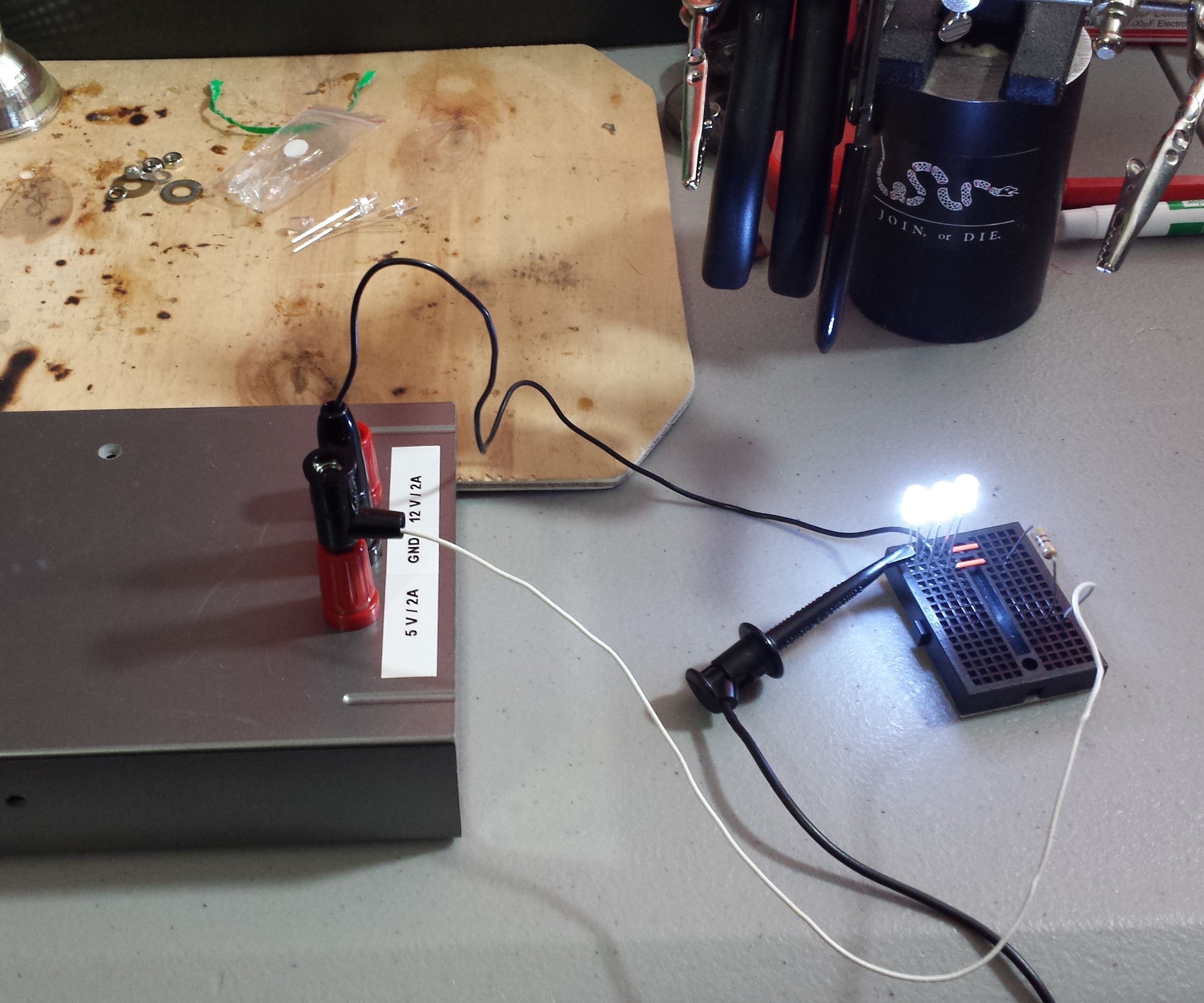

Step 5: Test It
Connect up an LED and see if you get light! Due to the high internal resistance of the battery, there is no need to connect a resistor in series with the LED.
In the second pictures the LED is pulling 0.21 mA. This is after a few days of the battery sitting around and then being soaked again in electrolyte, so you will probably see a higher current with a fresh battery.
